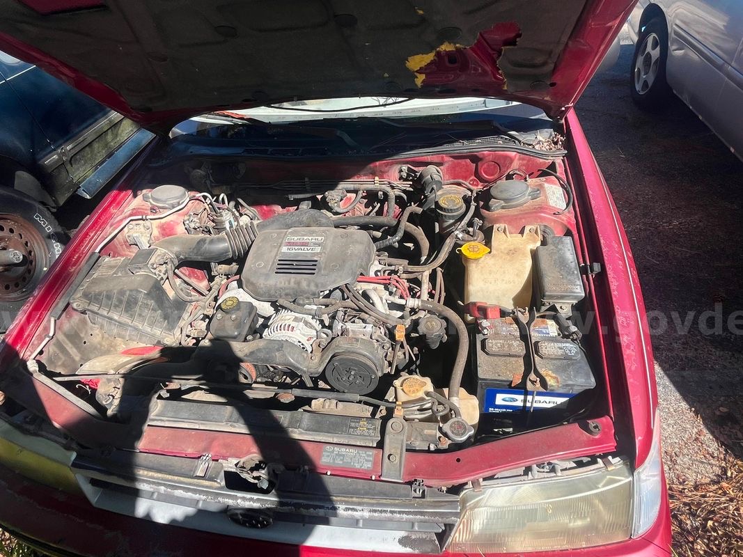

  5. If you zoom in to the passenger side of this underhood shot (this came from the original auction listing before I bought it) you can see the socket retainer clips loose on the back of the headlight shell.
  6. As a matter of fact the headlights are a particular problem. In the little bit of time I’ve been able to spend under the hood I discovered some wiring has been damaged/chewed including the headlight wiring. In fact the sockets themselves are gone and wire is missing on both sides all the way back to where it comes out of the loom inside each fender. I also found damaged wire at the cam position, crank position and knock sensor plugs so that’ll have to get fixed right away as well. let me know what you want for the headlight setups, the lenses themselves are a bit foggy but I’m not opposed to polishing them for the time being.

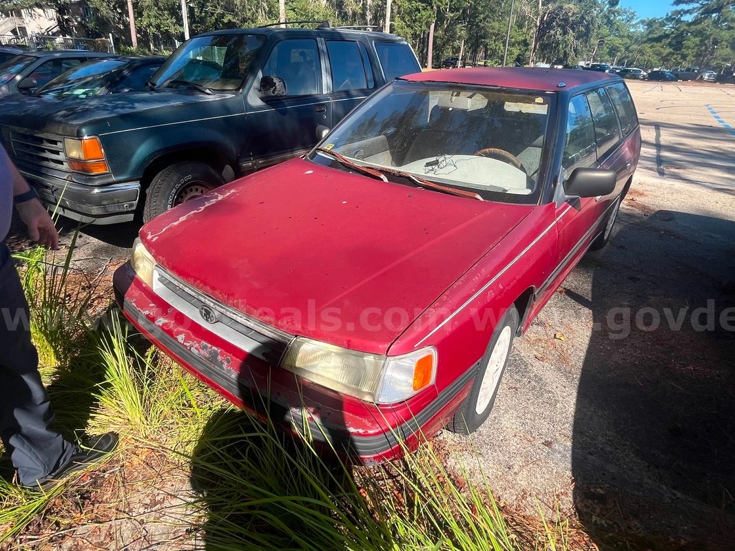

  7. Just picked up a 1990 Legacy Wagon L-Series from a local diesel tech school. Didn’t want it, didn’t need it, but it was an auction and I thought someone would outbid my lowball. So now it’s in an empty lot beside my house and before my HOA bitches about it I’ve got to get it running. Previously had an 00 Outback that I loved but we lost it to a deer strike on a backwoods highway in Florida. So I’m moving backwards, next I’ll get a B.R.A.T. or GL wagon then work my way down to a 360 but that’s a problem for future me.
