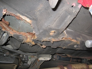

http://www.ultimatesubaru.org/forum/attachment.php?attachmentid=5024&stc=1&d=1183392124 Is this even safe to drive? Might be a parts car available soon. '87 GL 3-door Steve
