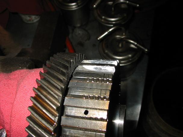

bgambino Posted September 20, 2009 Author Share Posted September 20, 2009 (edited) grossgary said: Do all the tires match tread depth, tire size, and pressure? Get those right. Sometimes torque bind goes away if all of that is take care of. Has the fluid ever been changed? One drain and refill doesn't get much fluid out keep in mind. Torque bind often goes away with that, I fixed one like that just this year. Last option: After those important things have been addressed then you can add GM Limited Slip additive (there's an entire thread, even a couple, on here about that). After that you need a used rear housing or new clutches. Duty C is optional in your case since yours is working. Price it out and see how you feel about replacing it while you're in there. ************* Gary yes, the tires are the same and are close Thanks for reminding me..I have to try maybe three flushes first,,,I can only hope that works The GM limited slip additive for the tranny?? It's an automatic New clutches? I thought it was a matter of just the grinding these spots (in pic) Edited September 20, 2009 by bgambino spelling Link to comment Share on other sites More sharing options...
