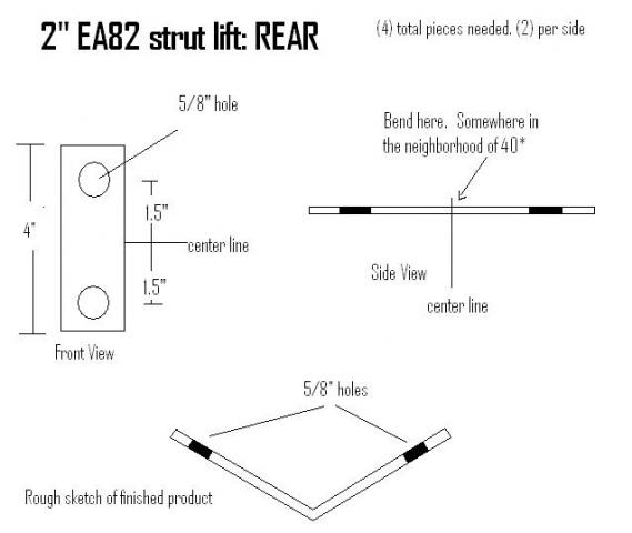

3eyedwagon Posted September 30, 2009 Share Posted September 30, 2009 That should take care of the fronts. Read it carefully, and you should be able to figure it out. The rears are the REALLY simple part. You just need 4 pieces of 1/4" X 2" flatbar. It doesn't have to be exactlt 1/2" X 2", but that is a good size. Anyways, you need 4 pieces measuring 4" in length. You need 5/8" holes drilled 1.5" from each end of the center of that 4" piece. Here's a rough sketch Link to comment Share on other sites More sharing options...
