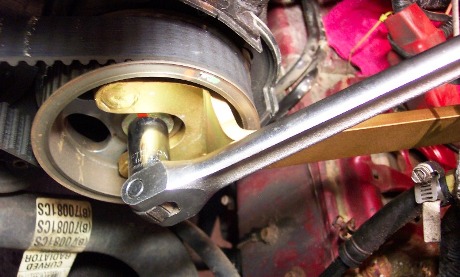

timfreddo Posted September 28, 2009 Share Posted September 28, 2009 im getting pretty frustrated now, with this oil seal leaking. have changed the oil pump seal and crankshaft seal, now just the matter of getting the cam pulleys off. its a quadcam 2L AT legacy 1994. am holding the pulley with a pair of massive adj pliers, and have someone else give the centre bolt all they have with a 3ft breaker bar, and we cant get it to budge. Any ideas? is it going to be this hard to do up the bolts again? How much is the inlet cam on the left side of the car allowed to spinbefore the valves collide? it has spun a quater turn a few times while i've been trying to undo the bolt. Cheers Tim Quote Link to comment Share on other sites More sharing options...
lmdew Posted September 29, 2009 Share Posted September 29, 2009 For the dual cam 2.2 engines, I take an old timing belt and cut it then wrap it around the cam and crank gear and pinch the belt together in the middle with a c-clamp or vise grips. Works great for breaking the bolt and torquing the bolt when you put it back together. Hope this helps Quote Link to comment Share on other sites More sharing options...
subaru360 Posted September 29, 2009 Share Posted September 29, 2009 I use an air impact with the belt still on. If the engine is in the car you have to have the radiator out and the a/c condensor flipped out of the way. If that's not an option for you, the 3 foot bar is the way to go, these things are really tight. If you round it off, drill the center out until the head of the bolt comes off. Then you can get the rest out by hand. Quote Link to comment Share on other sites More sharing options...
idosubaru Posted September 29, 2009 Share Posted September 29, 2009 the initial loosening is crazy on these, usually is. impact is the way to go. my buddy had one last week that bent the subaru "special" tool, breaker bar, chain wrench, rubber straps broke..nothing would touch this one bad bolt on a DOHC, all the others came out. he eventually got it with an electric impact wrench. i told him it wouldn't work, glad i was wrong! it was only rated at 150 ft/lbs i think (the wrench), but it buzzed it off. Quote Link to comment Share on other sites More sharing options...
