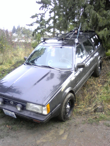

Markus56 Posted October 9, 2009 Share Posted October 9, 2009 (edited) I zip tied some wal mart lights onto a thule roof rack and ran the wires in the gutter down the A pillar down to under the hood. works great. you can kind of see the wire behind the radio antenna, but other than that it is invisible the only problems i had were when a tree branch broke off one of the lights. thanks to the zip ties, it didnt sustain any damage and i found it on the ground 2 days later and re-attached it. Still works! Edited October 9, 2009 by Markus56 Quote Link to comment Share on other sites More sharing options...
