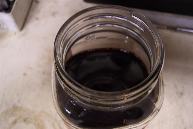

What kind of condition is the fluid in?
nipper
Please take a look below - very dark, but didn't really see metal in the fluid:
