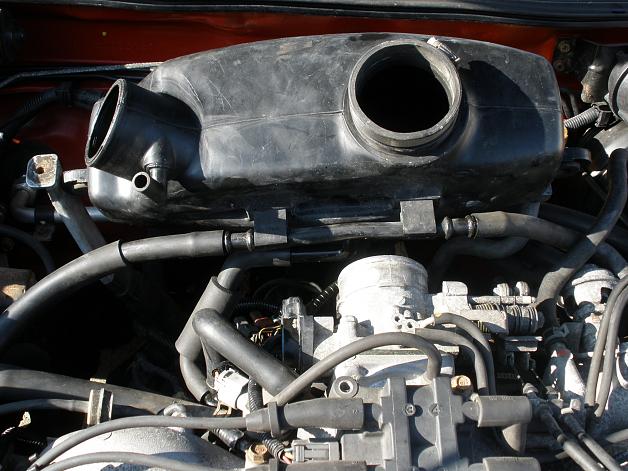

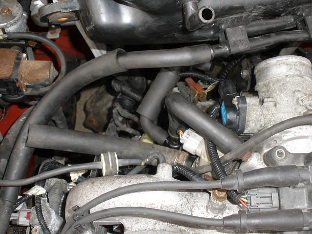

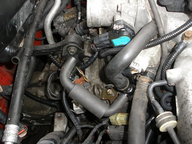

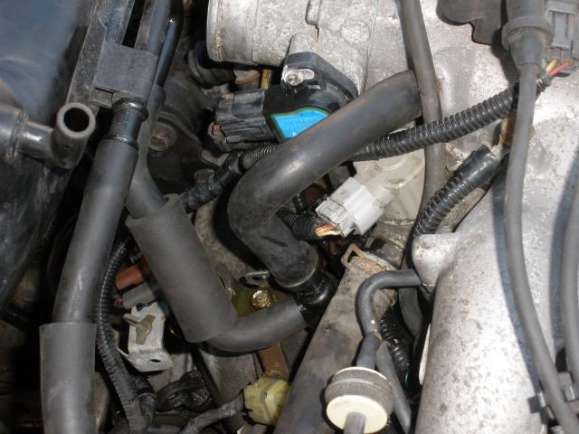

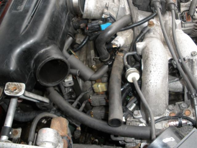

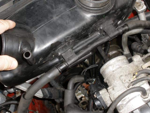

Gene J Posted November 22, 2009 Author Share Posted November 22, 2009 I thought I had it. Sometimes it is better just to walk away for a while. I think I uploaded the pictures. The first picture I am fairly sure of. That is from the tube from the MAF to the air box. There is one hose that goes to the block. They ar ean inch apart in the picture. In the first and second pictures you can see how the T goes to the block, throttle body and underneath the air box. Below the airbox are two hoses going to each cylinder head. Picture three has a better view. In picture four there is an empty nipple. This actually opens into the air box. I started the car and it will not idle because of the air leak. The diagram on the hood did not help much. And Subarus are not as common as I would like around here so I could look at an example. Let me know if any other views would help. Thanks . Link to comment Share on other sites More sharing options...

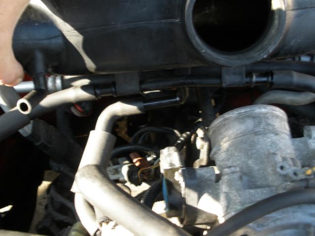

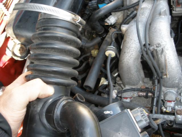

Gene J Posted November 23, 2009 Author Share Posted November 23, 2009 Perhaps these pictures would help identify the hoses. The questions are 1) What hoses go to the air box? There is a plastic molded tube that goes under the bow and I believe it connects to long hoses from each cylinder head. There is a T on this that goes to the PCV? There is a blind nipple on the back that is sealed and facing forward of the box that opens into the box. 2) What hoses go to the what looks like a T coming from the center of the block? The bottom goes into the block obviously. The one on the side is kind of U shaped and I am not sure where that goes. The top I have connected after the throttle body. Is that correct? Like I said this is kind of embarrassing. :-\ Link to comment Share on other sites More sharing options...
Gene J Posted November 23, 2009 Author Share Posted November 23, 2009 Here is one other pic that somehow did not up load. Hope this helps. Thanks Link to comment Share on other sites More sharing options...
Fairtax4me Posted November 24, 2009 Share Posted November 24, 2009 The two breather hoses should not connect to that same tube under the air box. The one from the left (passenger) side cylinder head goes to the tube that's behind that. The one from the T connects to the tube that crosses over to the right side cylinder head. The one that sticks out of the front of the air box... I'm not sure. Link to comment Share on other sites More sharing options...
kd7dej Posted November 24, 2009 Share Posted November 24, 2009 That's why it's something I am not completely familiar with, I get out some colored tape or masking tape with a marker and mark them before I take them apart. Just a little advice for next time. Link to comment Share on other sites More sharing options...
Gene J Posted November 24, 2009 Author Share Posted November 24, 2009 kd7dej said: That's why it's something I am not completely familiar with, I get out some colored tape or masking tape with a marker and mark them before I take them apart. Just a little advice for next time. Ordinarily that is what I would do like when I remove an engine.. However I disconnected a few other hoses to get the that coolant hose and got in too deep. Does anyone else have a 1998 EJ 25 that can take a look? The questions are where do the hoses go from the air box and where do the hoses go from the T that connects to the block. Thanks! Link to comment Share on other sites More sharing options...
gl2tosl2 Posted November 26, 2009 Share Posted November 26, 2009 Gene J said: Ordinarily that is what I would do like when I remove an engine.. However I disconnected a few other hoses to get the that coolant hose and got in too deep. Does anyone else have a 1998 EJ 25 that can take a look? The questions are where do the hoses go from the air box and where do the hoses go from the T that connects to the block. Thanks! I've got a 98 legacy obw with a ej 25. I've marked up a couple of your pictures. I'm calling the rubber pieces you can remove hoses, and the connections coming out of the airbox tubes. Hose #1 goes from the y in the pcv system to the tube that I've marked as #1 in the air box. The two hoses in the same picture as tube #1 should stay where they are in that picture. Hoses #2 and #3 don't attach to #1. They go from tube #3 that I've marked in the picture to tube #2, that is on the back side of the airbox -- opposite of where the airbox connects to the throttle body. So yes, hoses #2 and #3 route one tube on the airbox to another tube on the airbox. Don't ask me why. Hope this helps. Link to comment Share on other sites More sharing options...
Gene J Posted November 30, 2009 Author Share Posted November 30, 2009 Well thanks for the help. I got the hoses reconnected but I have one extra hose. There is no air leak and it runs great. Link to comment Share on other sites More sharing options...
