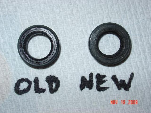

phantomcrooner Posted November 20, 2009 Author Share Posted November 20, 2009 Okay, The new main seal will be here tomorrow, so i tore the engine down to that point again. When I took the two sprokets off the crank, they were dry with no fresh oil and it does not look like it is leaking, directly under it though is the oil pump sprocket and the block around it has no grease just fresh oil. I am going to take the oil pump back off as I have found that I also have an oil pump shaft seal, it looks just like a main seal only smaller. Link to comment Share on other sites More sharing options...
phantomcrooner Posted November 20, 2009 Author Share Posted November 20, 2009 The oil pump shaft seal was really worn, I think its the culprit, since I dont have the main seal yet, and i can put it back together in about 30 min I will see if this is it. As you can see it is really bad. Link to comment Share on other sites More sharing options...
GeneralDisorder Posted November 20, 2009 Share Posted November 20, 2009 Interesting - yeah you might have something there. Make sure the shaft doesn't have a nasty groove in it where the lip on the seal was located. GD Link to comment Share on other sites More sharing options...
phantomcrooner Posted November 20, 2009 Author Share Posted November 20, 2009 WOO HOO!! The oil pump shaft had no signs of wear, but that shaft seal was so loose i pulled it out with my fingers and it was hard as a rock. I know that the Mickey Mouse seal was leaking some since it was smashed flat and torn in one section and the shaft seal was leakingeven more. I did put it back together and drove it easy and no leaks, so i drove it hard for a couple miles and still no leakes. The crank shaft seal is still soft and plyable, so i'll just put it in the back with my spare timing belts. Thank you all for your help, I really appreciate it. Link to comment Share on other sites More sharing options...
