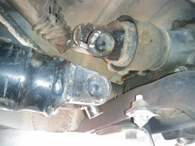

gwilson87 Posted November 24, 2009 Author Share Posted November 24, 2009 Well... This is just awesome. The clunking went away, but thats because the UV joint snapped while my wife was getting off the freeway on her way to class this morning. Im going to pick it up with a trailer later today and should have better pics but these will have to suffice. Anyone know of driveshafts from other cars that are the same length? I don't want to drop a ton of money on a new one, I would rather sell the car, haha. Sorry if the quality isn't great, I only had my phone. Link to comment Share on other sites More sharing options...

gwilson87 Posted November 25, 2009 Author Share Posted November 25, 2009 Yup, new clutch for sure. and Exedy at that. I think the driveshaft decided to mangle the shifter linkages as well because when I was getting ready to put it on the trailer last night it was REALLY sloppy and was very difficult to find gears. Haven't worked on it any yet due to my cold/flu. Hope to get it up on jack stands and at least pull the front part of the shaft off (leave the rear part adn carrier bearing up there). Its convenient where it broke since I can leave that little stub inside the end of the trans to hold the fluid in. Fun stuff, when I get it off I will have better pictures of the damage. Im going to mount this driveshaft on my garage wall as a trophy. Oh and yes it is an impreza outback sport. No real bad problems until this last month. Link to comment Share on other sites More sharing options...
Fairtax4me Posted November 25, 2009 Share Posted November 25, 2009 The shifter bushings might have gotten thrashed and trashed when it broke. Looks like the boot around the selector rod is torn in the pic. The bushings are cheap from a dealer, the boot you might as well get from a junk yard. You'll be right in that area getting the drive shaft out so it shouldn't be too difficult to yank that out at the same time. Link to comment Share on other sites More sharing options...
