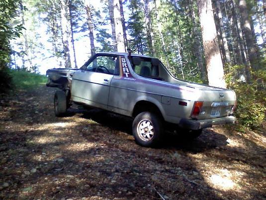

subaholic79 Posted March 27, 2010 Share Posted March 27, 2010 got her lifted and looks great! Link to comment Share on other sites More sharing options...
