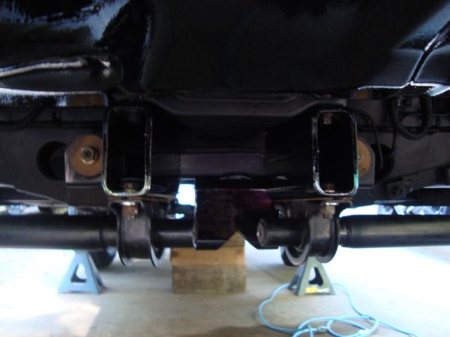

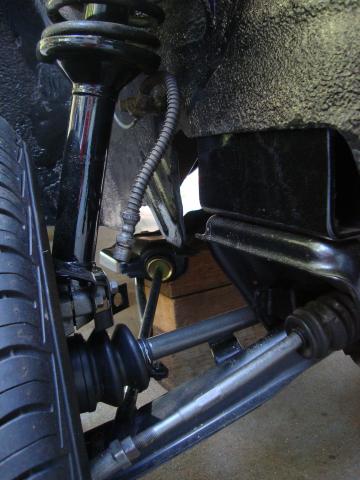

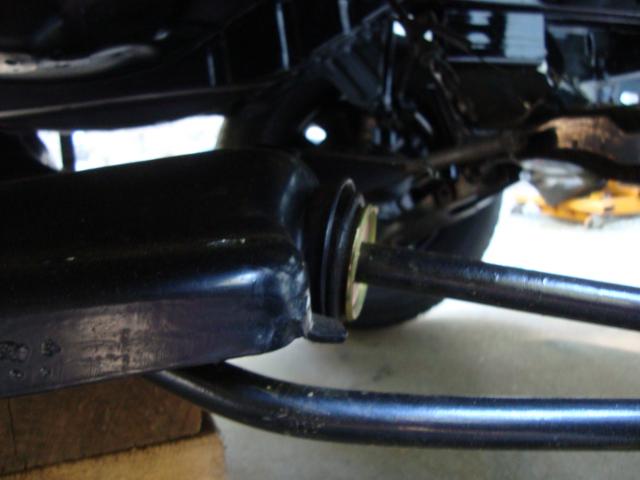

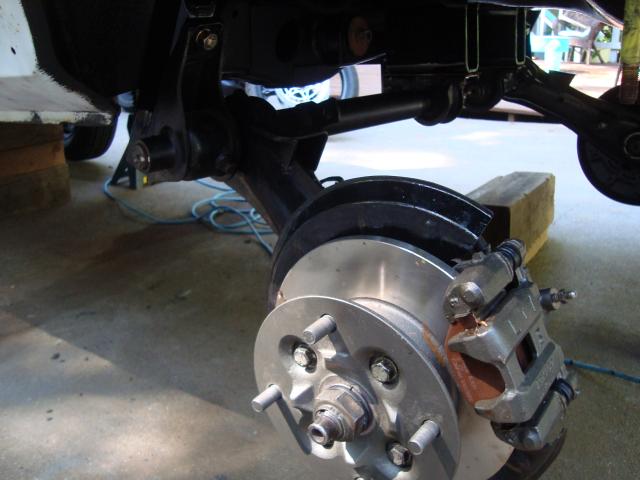

talldude Posted July 13, 2011 Share Posted July 13, 2011 Hi Bill, I bought RebelYJ's 4 inch lift kit last year and am almost finished with the install on my '78 BRAT. One issue: The front suspension leading rods appear slightly short with the lift blocks in. To make the recommended torque on the leading rod nuts (at the back) I have to tighten them all the way to squish the rubber bushings. After doing that, I'm about half a bolt hole off the trans crossmember lift block. Any thoughts on the best way to fix this? My truck isn't bent as far as I can tell, and I haven't test fit the engine/trans to see if the 2 crossmembers are the correct distance from each other. Should I just shim the leading rods to the lift blocks? Also, have you found any coilover shocks (or regular shocks) that fit after the lift is installed? Anyone else's thoughts on this would be appreciated. Thanks for the kit-nice job. Link to comment Share on other sites More sharing options...
danrenfroe2016 Posted July 13, 2011 Share Posted July 13, 2011 Talldude, Please post a picture of your problem as I am kinda confused. Also there will be some play in the whole front end setup as that is a lot of bolt holes. Also I found That I had to slot one set of holes on one side only slightly (about .25" or so as I didn't want to bend and put a torque on the frame or the transmission, .25 inches won't do anything bad to the geometry of the motor / trans. Also make sure nothing is backwords. -Daniel Link to comment Share on other sites More sharing options...
talldude Posted July 14, 2011 Share Posted July 14, 2011 I'll post a few pics as soon as I can get out there with a camera. It seems that the leading rods (they connect the front lower control arms with the trans xmember) dictate the distance between the engine and trans xmembers, and I don't want to load up the control arm bushings too much, either. I'd say I'm .25+ inches aft on my trans xmember lift block holes, all 4. Regarding the shocks question, I meant rear shocks. Can't wait to drive this thing in the snow here- it's gonna be great! Link to comment Share on other sites More sharing options...
talldude Posted July 14, 2011 Share Posted July 14, 2011 Here's pics of the undercarriage (hopefully they are attached). The trans xmember blocks are not installed as I am undecided as how to proceed: shim the leading rods so all blocks bolt on, or slot the holes in the xmember lift blocks to fit to the leading rods and engine crossmember. I just don't want to throw off the engine/transmission mount relationship. Link to comment Share on other sites More sharing options...
danrenfroe2016 Posted July 15, 2011 Share Posted July 15, 2011 wow, all i can say is CLEAN! i would slot one set of holes slightly, then bolt everything up and leave the slotted holes slightly loose, let the car down and see how it sits... Looks like its going to be great. Oh and for the Rear suspension, I will upload a pic or two of my setup, I used some monroe load leveler shocks from some olds that was in the monroe book, found a shock with same travel as original brat, different length though. They sure help when the rear is loaded down or pulling my brat trailer, they give just 200# push each when the load is heavy and help keep the rear from squatting, although it does not increase the carry capacity, it sure makes the car look better when loaded... -Daniel Link to comment Share on other sites More sharing options...
danrenfroe2016 Posted July 15, 2011 Share Posted July 15, 2011 (edited) I'll post a few pics as soon as I can get out there with a camera. It seems that the leading rods (they connect the front lower control arms with the trans xmember) dictate the distance between the engine and trans xmembers, and I don't want to load up the control arm bushings too much, either. I'd say I'm .25+ inches aft on my trans xmember lift block holes, all 4. Regarding the shocks question, I meant rear shocks. Can't wait to drive this thing in the snow here- it's gonna be great! OK, here is the part i used: http://www.rockauto.com/catalog/moreinfo.php?pk=294387 Part number is Monroe 58270 ST. This shock is a front shock made for a big OLDS from the 70s or 80s, cant remember the exact car now, but it does really well on the rear of the brat. I had my fab shop build this bracket for me and installed as shown in this picture as the travel is correct but the overall length is not with the lift. Oh and YES SNOW / ICE is Awesome, even in Dallas, I pulled out several full size pickups that were spinning and stuck on the curb on the ice with the little brat. people could not believe that my little brat with 67 HP could move there big bloated trucks and without slipping! Here is my FUN ice Video: pic one http://img850.imageshack.us/i/cimg0463u.jpg/ Pic two http://img28.imageshack.us/i/cimg0464b.jpg/ All progress Photos: Also I have a drawing for the steel shock mount if you want it. email me at (my USMB user name) @gmail.com -Daniel Edited July 15, 2011 by danrenfroe2016 left out part number! Link to comment Share on other sites More sharing options...
talldude Posted July 16, 2011 Share Posted July 16, 2011 Thanks for the info. I am leaning towards slotting the trans xmember lift blocks, as I figure the leading rod dimension is a good one for the engine to trans xmembers relationship. Mine has been in pieces so long it feels like it will never get done, but a little bit each week...I hope to be driving it by next spring. Nice pix of your rig too, BTW! Link to comment Share on other sites More sharing options...
talldude Posted July 20, 2011 Share Posted July 20, 2011 OK, I slotted the trans xmember blocks about 3/8 inch and everything bolted up. Now to see how the engine and trans mounts fit with everything assembled. Link to comment Share on other sites More sharing options...
