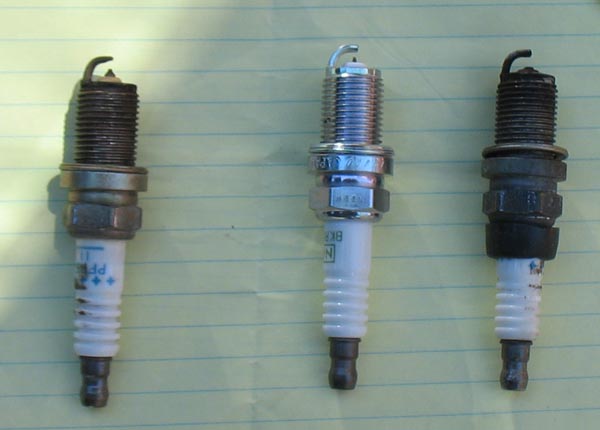

Kwhistle Posted December 13, 2009 Author Share Posted December 13, 2009 Just to update this thread, finally replaced the spark plugs today. Seems like the car is starting smoother, but today was a warm day. The plugs look like they are the originals that came with the car. Can't believe the thing actually drove with these! Here's a pic, the new NGK Platinum is the middle. Link to comment Share on other sites More sharing options...
