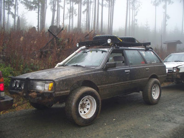

Markus56 Posted December 10, 2009 Share Posted December 10, 2009 (edited) Before install side shot In action! That is my roof rack. It is a modified bunk bed. All I did was weld some ends on it and add light tabs. And paint it flat black :cool: And now it has 4 spot lights instead of those two round lights And i don't use a fairing; i like the whistling sound i make when i drive by Edited December 10, 2009 by Markus56 Link to comment Share on other sites More sharing options...

Markus56 Posted December 10, 2009 Share Posted December 10, 2009 I have 4" (i think) thule bars which holds the rack What is holding everything together is 6 hose clamps. Three on the front rack, 3 on the back. I have not had any problems so far... Link to comment Share on other sites More sharing options...

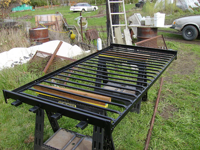

brysawn Posted December 16, 2009 Author Share Posted December 16, 2009 here's mine: and here's how it mounts to my yakima rack: cost me zero, and took about 2 hours to cut, weld, and paint. Link to comment Share on other sites More sharing options...
The Dude Abides Posted December 16, 2009 Share Posted December 16, 2009 What did you use for that. Heres the beginning of mine. I need to configure up a basket. Link to comment Share on other sites More sharing options...
brysawn Posted December 16, 2009 Author Share Posted December 16, 2009 It's just angle iron, and some steel channeling. With pipe clamps, and hooks welded to it It's 36" x 30" Link to comment Share on other sites More sharing options...
