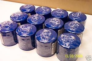

I just installed my last black AA100 filter and was looking to buy some more and found out it's now blue AA12A. has anyone put these side by side? And just read that the internals are by Honeywell (FRAM) and plastic valve?
In this picture they look a little longer.
Every manufacturer of filters has the ability to produce both high end and low end filters. I wouldn't be concerened that the OEM on them is the parent company of Fram. There's many, many products that you could avoid buying because the parent company also owns another unit that makes cheap throw-away stuff. That's business for you. Where there's a demand, there will be a product.
GD
huh? I suspect the backyarder demand has decreased so they decided to reduce the costs of importing the Tokyo Roki and go with a manufacturer (canada) that met specs at a lower price point. I doubt they will be charging less for the cheaper (for SIA) filter eh? Since I can't confirm an aftermarket filter that states 23 psi bpv (using 5w30) I will probably stick with OEM even with cardboard endcaps and silicone anti-drainback (cause it's useless on vertical filters?). ebay case of 12 for 5.17 each-is that good?
