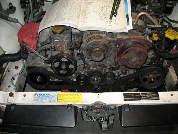

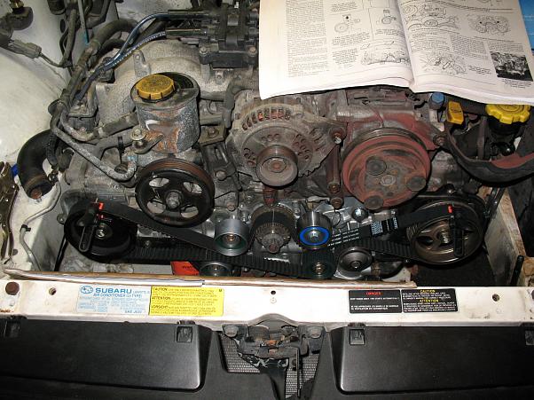

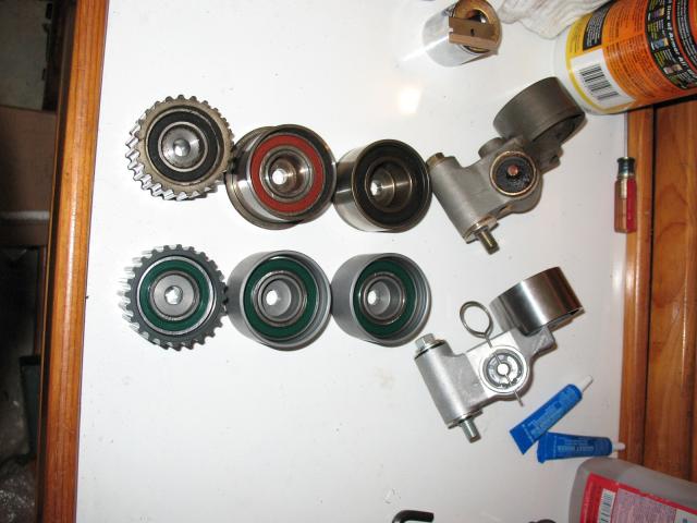

lewisd Posted January 5, 2010 Author Share Posted January 5, 2010 (edited) I did 125 ft/lb with blue loctite on the crankshaft bolt. couple pictures, before, old new parts side by side, and after. Edited January 5, 2010 by lewisd Link to comment Share on other sites More sharing options...
