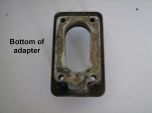

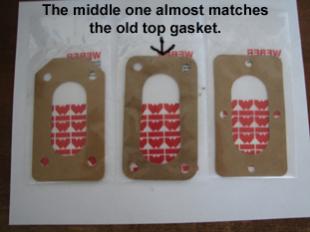

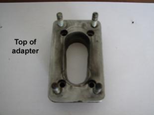

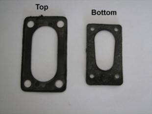

All4EA81 Posted December 27, 2009 Share Posted December 27, 2009 (edited) Greetings Everybody, I'm rebuilding my 32/36 DGAV Carb and I'm having a hard time finding just the adapter gaskets online. I ordered the rebuild kit and adapter gaskets from http://www.webercarbsdirect.com/ and they sent me the wrong ones. I went to http://www.redlineweber.com/ ,looked at the Subaru kits, and it gave me the part# 99004.110 for the adapter. I looked under the gasket kit for this particular adapter and its unlisted. Anybody run into this? Anybody know a good smart distributer that can help and won't be confused with my problem? Anybody recognize the wrong gaskets webercarbsdirect sent me? Anybody recommend just making my own? Edited December 27, 2009 by All4EA81 Link to comment Share on other sites More sharing options...

All4EA81 Posted December 27, 2009 Author Share Posted December 27, 2009 Thanks hatchsub. I'm looking for the top and bottom gaskets for the adapter plate. Link to comment Share on other sites More sharing options...
cawain Posted December 28, 2009 Share Posted December 28, 2009 Just go to the parts store and get some gasket material of the proper thickness and make yout own gaskets. Lay the adaptor on the material and trace it out, than take an exato knife and cut it out. I have a hole punch from harbor freight to punch the mounting holes with, but the rest I just cut out. Make them all the time and they work great. Link to comment Share on other sites More sharing options...
TheSubaruJunkie Posted December 28, 2009 Share Posted December 28, 2009 Yeah i gave up looking for gaskets long ago. Just get a sheet of gasket paper and a good exacto knife. Use a single hole punch to make the holes for the studs. Link to comment Share on other sites More sharing options...

GeneralDisorder Posted December 29, 2009 Share Posted December 29, 2009 Put the peice of gasket paper over the plate and then just use the rounded end of a small ball-peen hammer and lightly tap your way around the profile of the plate you are making the gasket for - this will cut the gasket exactly to fit. You can then either mark and hole-punch the bolt holes in it or you can use a small ball bearing and your hammer to punch those as well. Making gaskets is no big deal really. Takes a couple minutes. I don't even bother buying stuff like that anymore. GD Link to comment Share on other sites More sharing options...
TomRhere Posted December 30, 2009 Share Posted December 30, 2009 ^^ I've done that countless times. The gasket set they sent you is for the EA-82 2-piece adapter. Link to comment Share on other sites More sharing options...
All4EA81 Posted December 30, 2009 Author Share Posted December 30, 2009 Just as a follow up if antibody's interested, Redline emailed me back giving me the individual gasket part #s. 444 110 03 manifold gasket 99005 068 carb base gasket The guy had to search for these #s because he couldn't find a gasket set # either. Don't know if these are the actual gaskets though. Maybe I'll order them if I need some jets or filter one of these days, just to make it worth the shipping. Link to comment Share on other sites More sharing options...
