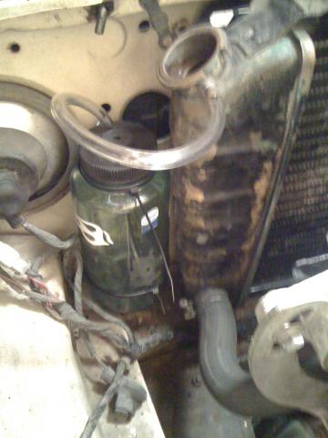

belyle Posted January 10, 2010 Author Share Posted January 10, 2010 I added a reservoir (see picture), replaced water pump, replaced thermostat, replaced upper hose, and refilled with coolant. After re-doing the thermostat gasket (pinched the thermostat in with the gasket, leaking coolant all over my garage), everything seems to be not leaking. When I was pulling the water pump, one of the bolts broke off in the block. I tried all afternoon Friday and all morning Saturday to remove it. I finally called it quits after trying everything I could think of (not an EZout), and everything my dad (who is a mechanic) suggested. I reassembled with only 4 bolts. I'm hoping that it will be enough. It was actually previously held on by only 4 bolts as well. Somewhere along the way, one bolt had fallen out. Link to comment Share on other sites More sharing options...
