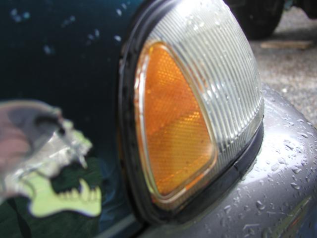

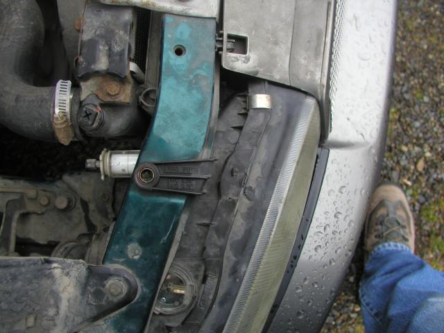

I got a 96 outback the car is not wrecked or was. But my right (pass) headlamp is not fitting in right. Is this some POS aftermarket part or are the legs different from OBWs
and they look a little different ...I think It could be shimmed but the grill wont fit

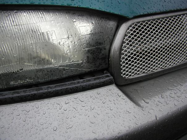

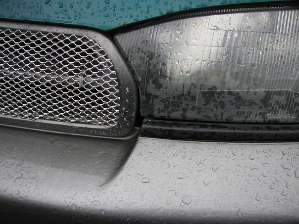

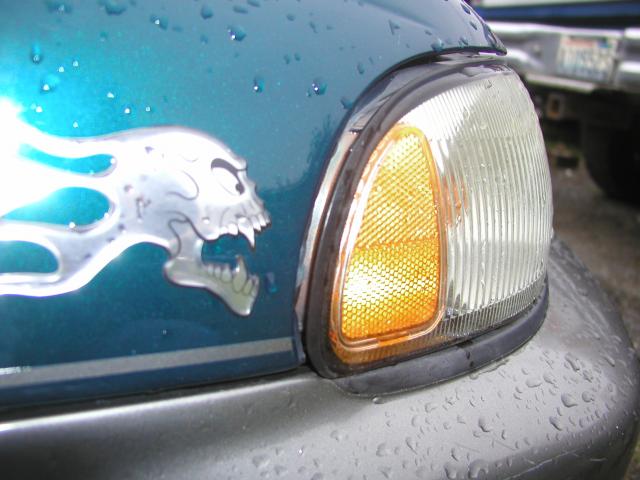

the headlamps I got look the same to the naked eye.... to the measuring tape there about 7/8" differ at the grill in the deepness thicker........ Driver side fits with body lines on both hood & bumper corner is tight......... Passenger side is thinner in depth at the grillside hoodline and bumerline does not lineup..... corner is cocked
Again the the car has not been wrecked .....I could shim to fit and it will
but grill wont fit

Aftermarket grille, looking like aftermarket/replacement bumper cover probably.

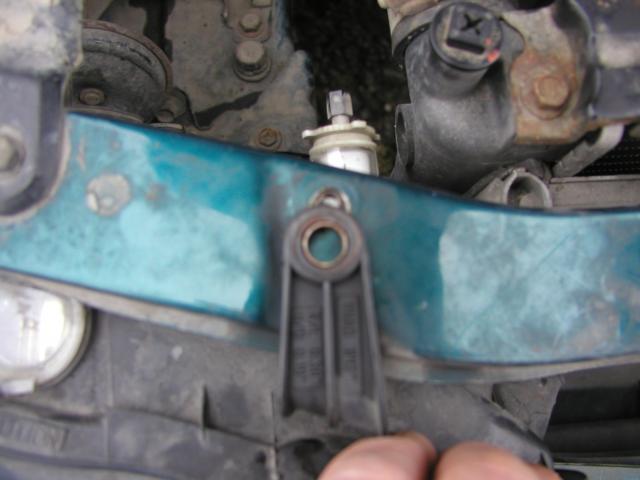

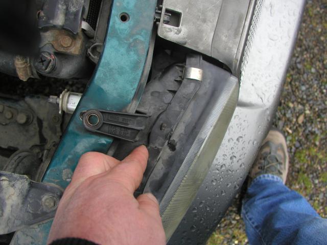

I've retrofitted the 95 one piece headlights into a 98 outback that had the 2 piece setup, so they're deffiniately interchangeable. The wiring for the bulbs is different so you have to do some cut and splice. I would take a close look at the body where the headlight attaches. I would suspect that the radiator support area may be pushed in a bit. It looks like the headlight is recessed in in relation to the hood too. Mabe stacking some washers between the headlight assembly and the body and useing a longer bolt would work for you?

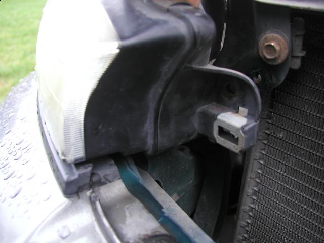

check very carful behind the lense for the bracket attaching it to the headlight bucket. they are NOTORIUS for having broken mounts, BEHIND the headlight lens. We had a really hard time finding used headlights for my brothers 99 outback. The tabs on top were broken on nearly all the junkyard ones, then my dad found one that had good top tabs, but after installing, figured out the back tabs were broken, which resulted in the headlight lens sitting back about 1.5" too far.
They made the buckets poorly on these and to find good ones takes mucho time. Even a junkyard sold us a "good" one, that turned out broken tabs, not to mention almost all are pitted, and yellowed to unusable conditions.
after looking at your pic, yes, the behind the bucket tabs on the headlight are fubar'd, the ones that hold the housing to the bucket.
Edited by bheinen74

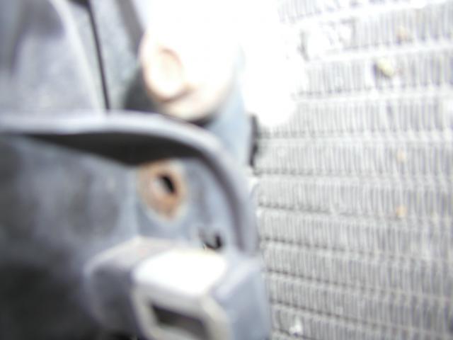

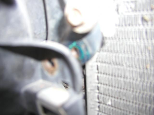

believe it or not nothing is broken or bent .........for those picks I only removed the two bolts you see missing,,, the third one was still in place. Without the third bolt in place I could easley adjust to a perfect fit.
I don't see anything missing. There is no "bucket" on these lights. Adjustment is done by moving the reflector inside the housing, not by moving the whole lens.
What gets me is the position of the hole for that inner bolt on the top support. It looks like it's too far back for some reason. I'll check mine in the morning and see what it looks like.
