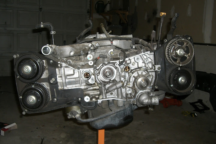

gwilson87 Posted February 10, 2010 Share Posted February 10, 2010 I feel your pain, I am in the process of rebuilding a 2.0 and got to this point, broke a strap wrench, and I feel like my breaker bar is just warping the bolt. I am letting it sit for awhile till I get air tools this weekend. Depending on how much room you have, if you took off the valve covers the camshaft might have a spot you can put a wrench to hold it stable while trying to break it free. you can kind of see the spot at the front of the camshafts where the wrench would go. I know my engine has one. But having the engine still in the car might make the whole wrench on camshaft a lil difficult. Make sure to post what works for you. Link to comment Share on other sites More sharing options...
svxpert Posted February 10, 2010 Share Posted February 10, 2010 gwilson87, can you post a picture of the front of the pulleys where the bolt is? thanks sorry to hijack the thread... Link to comment Share on other sites More sharing options...
gwilson87 Posted February 10, 2010 Share Posted February 10, 2010 is this what you wanted to see? I can get better shots as well, nothing better to do tonight.... Link to comment Share on other sites More sharing options...
