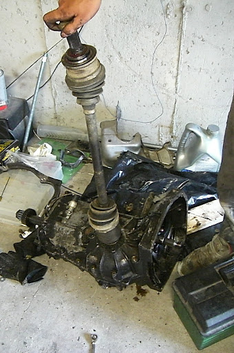

gwilson87 Posted July 14, 2010 Author Share Posted July 14, 2010 got my flywheel and clutch all mounted up Now is the debate of what to do for axles. I could do as austin did and put EA82 DOJ cups on the end of my impreza axles, or I could try and replace the stubs in the front diff to have 25 spline and then I could just use newer axles. Any thoughts as to the difficulty level to doing such a thing? Im scurred i would open the trans and gears would just come falling out all over the place haha. Link to comment Share on other sites More sharing options...

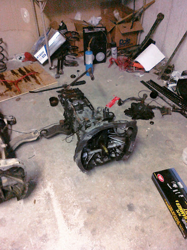

gwilson87 Posted July 18, 2010 Author Share Posted July 18, 2010 I got some stuff done. Here are pictures to prove it. Whats this here... Make sure the flange is looking like this, if not then rotate it because the other set of gears won't go back in if its opposite, trust me. Front Diff from my stock OBS 5 speed. 3.9 gearing with 25 spline stubs so I can use my stock axles. DO NOT FIDDLE WITH THIS!!! I did, things slid around, little pieces of metal fell out, spent forever getting it back together and I am hoping everything went back together right. This is the 4wd gear stuff (I don't know technical mumbo jumbo) One day my wife might get to park her wrx here again... This little stub here... Lines up with this little hole here... Looks like everything is there.... :-\ Yay!!!! Main case together, gonna let the sealant dry then torque up, then get the rear case on tomorrow. 25 spline obs axle on 5 speed dual range trans. Makes me a bit giddy Link to comment Share on other sites More sharing options...

superu Posted July 18, 2010 Share Posted July 18, 2010 I love your attention to detail I got some stuff done. Here are pictures to prove it. Whats this here... Make sure the flange is looking like this, if not then rotate it because the other set of gears won't go back in if its opposite, trust me. Front Diff from my stock OBS 5 speed. 3.9 gearing with 25 spline stubs so I can use my stock axles. DO NOT FIDDLE WITH THIS!!! I did, things slid around, little pieces of metal fell out, spent forever getting it back together and I am hoping everything went back together right. This is the 4wd gear stuff (I don't know technical mumbo jumbo) One day my wife might get to park her wrx here again... This little stub here... Lines up with this little hole here... Looks like everything is there.... :-\ Link to comment Share on other sites More sharing options...

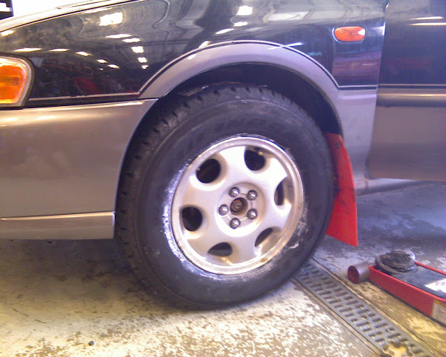

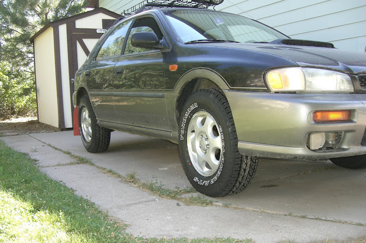

gwilson87 Posted July 23, 2010 Author Share Posted July 23, 2010 IT DRIVES!!!! took a quick trip to discount tires Test fit some 215/75r15's to see how they fit Very little rubbing in the back, probably take the mudflap off I will be fine. Might get some paranoid fabrications strut tops just to give a little extra clearance for the tires. Ordered these in the 215-75-15 Should be here thursday!!!! So stoked! Link to comment Share on other sites More sharing options...
Gloyale Posted July 24, 2010 Share Posted July 24, 2010 Front Diff from my stock OBS 5 speed. 3.9 gearing with 25 spline stubs so I can use my stock axles. Hopefully the lack of a bevel on the IMP ring gear, for the D/R shift collar, won't interfere with anything. Or at least swapped over the ring gear onto the IMP chunk. I would have used the original D/R's front diff and just swapped axle stubs. I've learned to be wary of mix and matching gears that have already been meshed for millions of rotations toghether. Also with a new ring gear in there I hope you rechecked the endplay and lash adjustment. Don't mean to be a downer......just keep your fingers crossed and I'd suggest changing the fluid every few hundred miles for the first thousand or so. Watch it for signs of wear.....and adjust the diff if needed. DO NOT FIDDLE WITH THIS!!! I did, things slid around, little pieces of metal fell out, spent forever getting it back together and I am hoping everything went back together right. This is the 4wd gear stuff (I don't know technical mumbo jumbo) That is the Dual range shift mechanism. the 4wd engagement is in the rear extension. But we get waht you mean. those little sliders and springs are a beaaach to get back toghether when they pop. Overall nice work and love the pics. Hopefully everything goes smooth for you. Got any pics of the trans crossmemeber and mounting? Link to comment Share on other sites More sharing options...
gwilson87 Posted July 25, 2010 Author Share Posted July 25, 2010 Yeah since I don't know anything about building transmissions I didn't check endplay. I didn't check backlash with putting paint on the ring and spinning it (as I was told about doing so 2 days later...) but I did spin it back and forth feeling for give and it felt very solid. I am definately going to be taking it easy for the first 1000 and change out oil every 200 or so. Found another 5 speed trans on the cheap around here so I might go buy it just to take the front diff and scrap the rest. Either way, for the moment its driving good and shifts well so that makes me happy. Link to comment Share on other sites More sharing options...

gwilson87 Posted January 8, 2011 Author Share Posted January 8, 2011 really been since july since I posted anything about this thing...? man I suck. Well it daily's really good. Does freeways alright, doesn't like to go uphill loaded with people to go skiing more than 25mph. makes me want to run an extra knob to have fwd lo... but here is whats happening tomorrow. Link to comment Share on other sites More sharing options...
