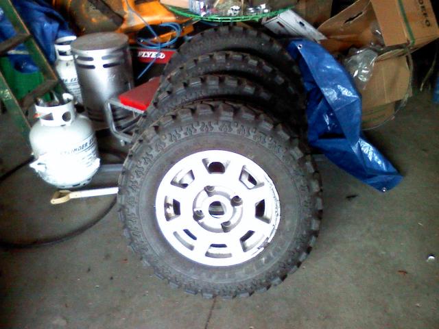

mcbrat Posted March 6, 2010 Author Share Posted March 6, 2010 got the SSRs mounted onto the pugs.... Quote Link to comment Share on other sites More sharing options...
Subarutex Posted March 6, 2010 Share Posted March 6, 2010 I miss my SSR's. Had I known you were looking for a daily, I would have made you a deal on my RX Quote Link to comment Share on other sites More sharing options...
