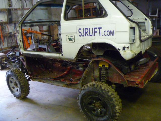

Scott in Bellingham Posted March 10, 2013 Author Share Posted March 10, 2013 heres the new specs 1987 EA82 wagon shortened 12" to a 85" whelbase, body removed Red car 88 Justy 2dr grafted on White car 96 EJ22 with 90 heads with Delta Low torx Cams stock FI with ECU and 90 legacy wiring harness 29" TSL swampers brand new after its drivable swap out the stock rear diff axles and suspension with a toyota truck rear axle with a lockrite and 3.9 gears to match the transaxle Link to comment Share on other sites More sharing options...

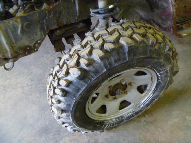

Scott in Bellingham Posted March 10, 2013 Author Share Posted March 10, 2013 (edited) stock Justy Ran a 90" wheelbase stock EA82 was 97" this thing is 85" will probably grow to 90" with the yota rear axle and move up to a 31" tire add ons later Solid rear axle front 8000 warn winch, rear 5000 Viper ATV winch bumpers, sliders, rollcage or exo or a little of each reinforced and designed front A-arms , I seam to always bend the stock ones tube or cut down doors maybe make the top removable air compressor and of course the flux capacitor from my last build Edited March 10, 2013 by Scott in Bellingham Link to comment Share on other sites More sharing options...
