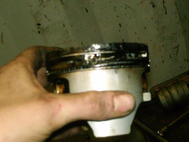

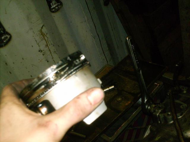

AWD TURBO! Posted March 15, 2010 Share Posted March 15, 2010 found my blow by problem the piston is bad so I'm going to use the na pistons & see how long this will last Link to comment Share on other sites More sharing options...
Nug Posted March 15, 2010 Share Posted March 15, 2010 Broken ring lands? Can't tell from the photo. If so, you are running into detonation. Link to comment Share on other sites More sharing options...
Ricearu Posted March 15, 2010 Share Posted March 15, 2010 Everybody here told you that running a crap load of boost would end that way the detonation was caused by running 26psi on stock fuel system :lol: next time leave it stock, it will run a whole lot longer Honestly if you want an engine to tear up, do what suberdave did and put an EJ20G into your car. you'll be much happier Link to comment Share on other sites More sharing options...
AWD TURBO! Posted March 15, 2010 Author Share Posted March 15, 2010 i know but it was fun i plan on doing a ej22 for my Rx but yes Broken ring lands i wish i could get good photo's and i will be running 7psi in the new one Link to comment Share on other sites More sharing options...
