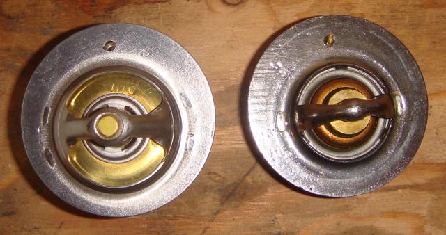

88 EA82T Posted March 24, 2010 Share Posted March 24, 2010 I have an 88 GL10 with the stock EA82 turbo and I replaced my thermostat back in September. I took some pictures to show the difference between the one that was in my car (on the right) and OEM one I replaced it with (on the left). The Subaru part number is 21200AA121. The big difference is the cross sectional area where coolant can pass through so the benefit would be more flow through the radiator which should improve the cooling efficiency. I hadn't seen a direct comparison like this on the board so I thought it would be good to add... Link to comment Share on other sites More sharing options...
Turbone Posted March 24, 2010 Share Posted March 24, 2010 The OEM thermostat has always been a recommendation here, along with the PCV unit. Link to comment Share on other sites More sharing options...
TahoeFerrari Posted March 24, 2010 Share Posted March 24, 2010 As long as same temp thermostat was used I wouldn't expect any problem, but it's probably not necessary: Some time back I experimented with a couple of EA82s to see if they would benefit from cooler thermostats. What I found is that if the thermostat temp was reduced by more than a few degrees the ECU would think that the engine was not up to operating temp (via the output from the engine-mounted coolant temp sensor) and seemed to run the engines richer that necessary and thus clobbered gas mileage. A change back to the stock thermostat temp and the gas mileage returned to normal. I repeated the cycle twice for about a month each time with 2 different EA82's and got the same results. Note that these were NA SPFI engines, but I would expect the same with a turbo engine. I also did this during the winter/spring when daily temps were cold to cool so it might help in summer but I suspect that during colder parts of the year it could actually hurt. Link to comment Share on other sites More sharing options...

GeneralDisorder Posted March 24, 2010 Share Posted March 24, 2010 hopefully when I get to Portland in May I can hit the u-pull it yards to find an intercooler setup... Not likely. I run the yards here every week and I haven't seen one in ages. Craigslist, etc would be a better bet. Or decide what model you want an IC from, find a forum for them and ask for a used one. As far as the thermostat - it's well known that the OEM one's are better. I took a similar comparison picture and posted it..... probably 5 years ago. GD Link to comment Share on other sites More sharing options...
