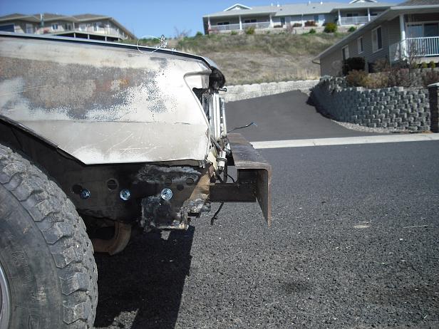

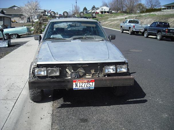

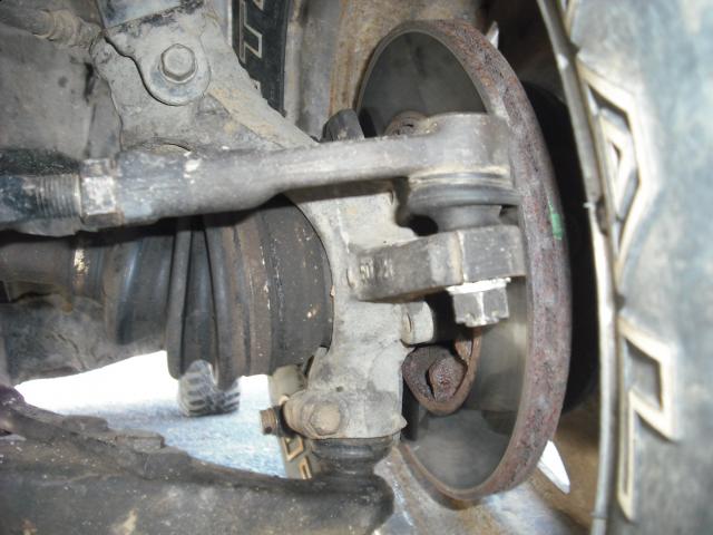

Uberoo Posted April 4, 2010 Author Share Posted April 4, 2010 (edited) So I took some pics of stuff.No pics of the welded diff because a welded diff looks about the same,no matter how you do it,Lots of Molten metal goodness! The bumper is made out of 3/16 angle iron.Never measured how big it is just picked it up from a buddies scrap pile and threw it on.It actually was the right size and no cutting was needed to size it correctly.However I still need to bevel the corners for better clearance to the tires.That and weld some D rings onto it.It is connected to the car with 2" C channel about 3/16" thick.That goes into the "frame" 24" with 3 7/16" bolts on each side holding it on.Its plenty sturdy.I was also able to modify my front fans to tuck them in closer so the bumper is pretty close to the body. radiator support is a piece of 1 1/2 or 2" thick wall square tubing also donated from my buddies scrap pile.Its welded to the body and the factory front tow points are bent inward to further strengthen it,Then they were welded to the square tubing. Then finally when I put the EA82 front suspension on I lengthened my stock EA81 tie rods.The Ea81 tie rods are bigger in diameter than the EA82 ones.So I ground out the TOP of the steering knuckle so they would fit.Then to take care of the small beveled hole at the bottom I jammed a couple small lock washers in there to take up the slack.Benefits- tie rods are at less severe angle at normal ride hight and all other suspension positions,resulting in less bump steer. Edited April 4, 2010 by Uberoo Link to comment Share on other sites More sharing options...
