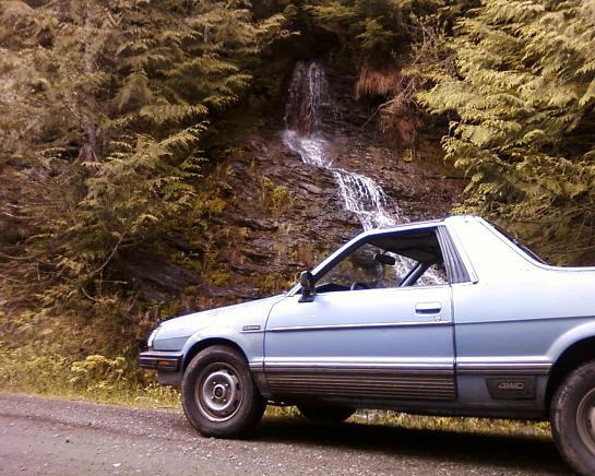

Dannomanno Posted May 8, 2010 Share Posted May 8, 2010 27x 8.5 no lift. Link to comment Share on other sites More sharing options...
Yo'J Posted May 10, 2010 Share Posted May 10, 2010 That thing needs a lift! You would be so happy! Link to comment Share on other sites More sharing options...

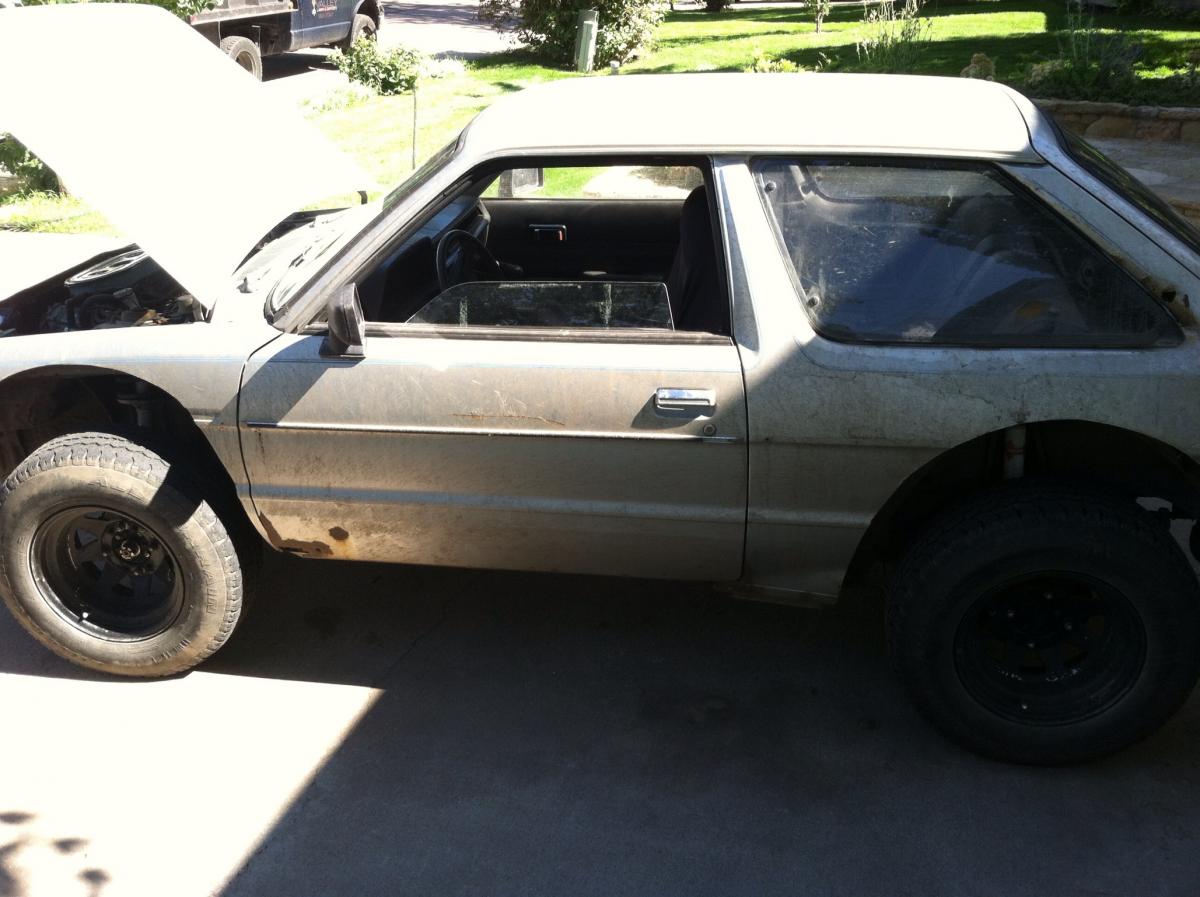

gmdagit Posted January 1, 2012 Share Posted January 1, 2012 (edited) I have a '84 wagon that stock ride that has 215/75R15 LT. I had to trim a lot and they still rub in the rear if i jump. Edited January 2, 2012 by gmdagit added photo Link to comment Share on other sites More sharing options...

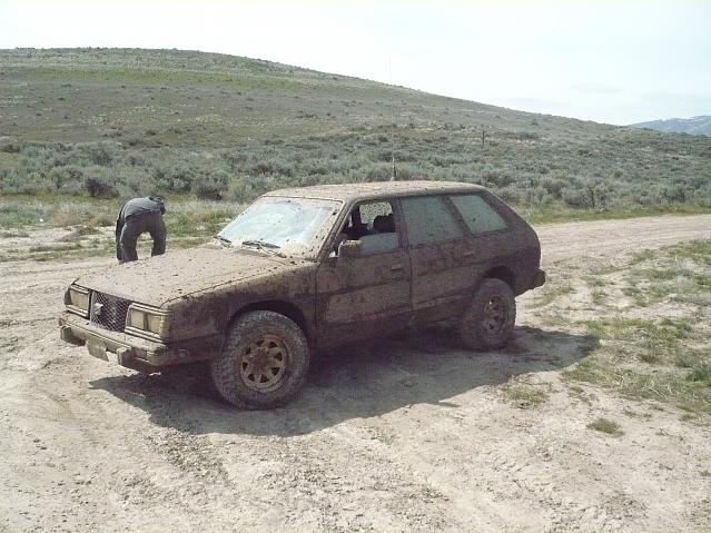

DJMCUSTOM4X4 Posted August 16, 2012 Share Posted August 16, 2012 Our 1981 MY. No lift, a little gard trim and on with the 29/12.5/15r Goodyear TERRA GRIP'S and i love em:headbang: 1 Link to comment Share on other sites More sharing options...

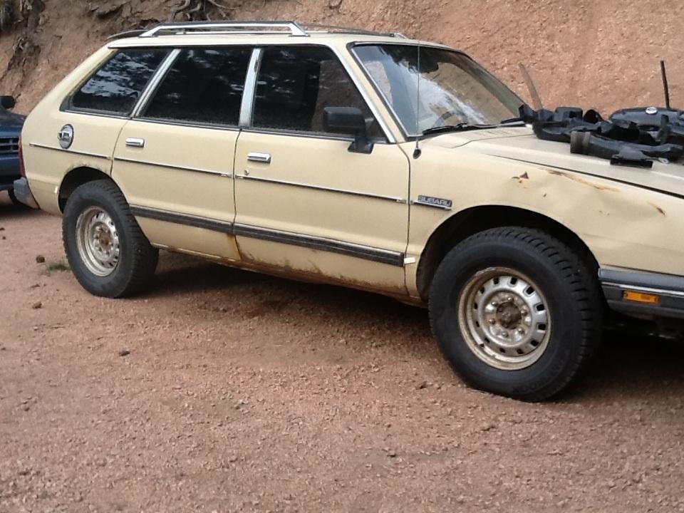

spazomatic Posted November 9, 2014 Share Posted November 9, 2014 Heres mine on isuzu rims and 205x75-14 Hankook Ipikes. No lift. 3" trimmed from the front, and 1.5" from the rear. Some light hammer work behind the front tires in the inner fender. Link to comment Share on other sites More sharing options...

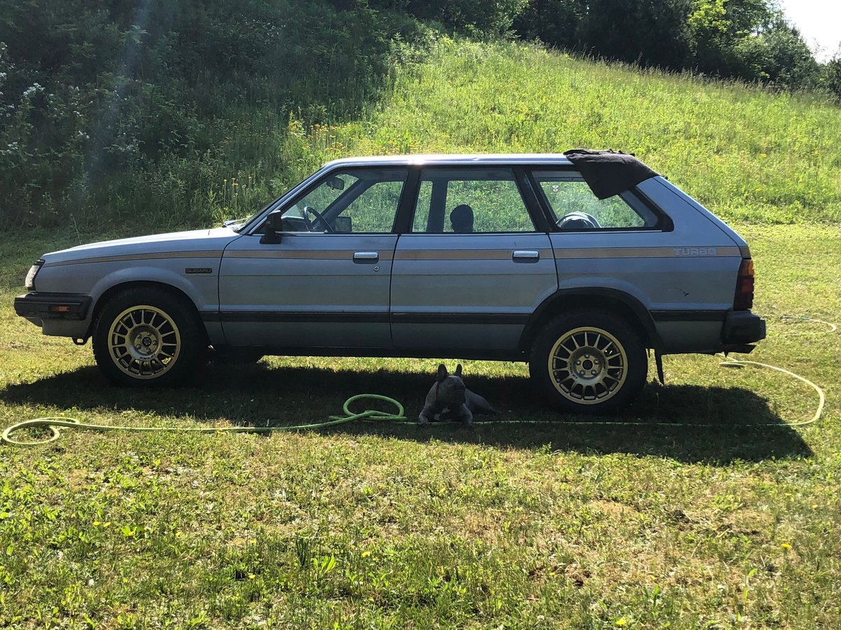

Lofti7 Posted July 18, 2018 Share Posted July 18, 2018 205-60r15 just a bit of rubbing at 3/4 lock but I have adaptors that are pretty thick Link to comment Share on other sites More sharing options...
