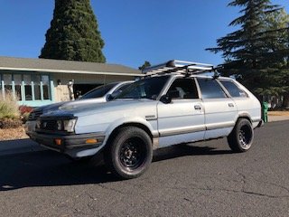

83subaruGLchick Posted October 19, 2018 Share Posted October 19, 2018 1983 Subaru GL stock height wheels are a 15x7 4 inch backspace and tires are a 205/60/15 which I believe are just short of 25 inches tall although they do stick out of the fender so I think that’s why I couldn’t go bigger and I had to trim on the back of the fender. Quote Link to comment Share on other sites More sharing options...
