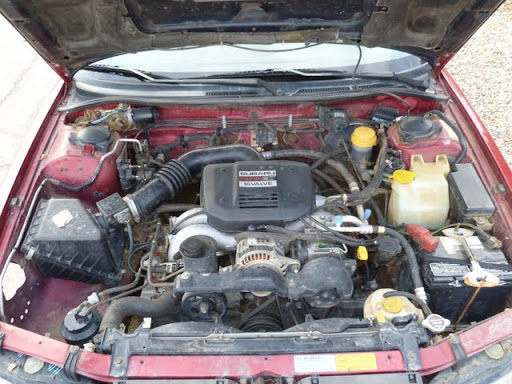

TheLoyale Posted February 4, 2011 Author Share Posted February 4, 2011 Retrofit first gen EJ22 cover. Link to comment Share on other sites More sharing options...
Durania Posted February 4, 2011 Share Posted February 4, 2011 What all was involved in the retrofit. I may snag the one off my grandmothers 91. Link to comment Share on other sites More sharing options...
TheLoyale Posted February 4, 2011 Author Share Posted February 4, 2011 What all was involved in the retrofit. I may snag the one off my grandmothers 91. Lol, "Gimmie that cover Granny!" All you need to do is trim a spot for the EGR and Vac lines so the cover will seat all the way down. You also need to the two metal brackets that bolt to the intake of course. Link to comment Share on other sites More sharing options...
Durania Posted February 5, 2011 Share Posted February 5, 2011 Your wagon auto? I don't think my 5 speed one has EGR. Link to comment Share on other sites More sharing options...
TheLoyale Posted February 5, 2011 Author Share Posted February 5, 2011 Your wagon auto? I don't think my 5 speed one has EGR. It should have an EGR I would think. But yes its a 4EAT. Link to comment Share on other sites More sharing options...
superu Posted February 6, 2011 Share Posted February 6, 2011 (edited) Retrofit first gen EJ22 cover. Lol, "Gimmie that cover Granny!" All you need to do is trim a spot for the EGR and Vac lines so the cover will seat all the way down. You also need to the two metal brackets that bolt to the intake of course. HAH, looks familiarly exactly like mine, even down to the strut top dust covers!! And some rubber grommets in the holes in those metal brackets hold the cover on nice and tight... Will get pix of the grommets for you... Edited February 6, 2011 by superu Link to comment Share on other sites More sharing options...
