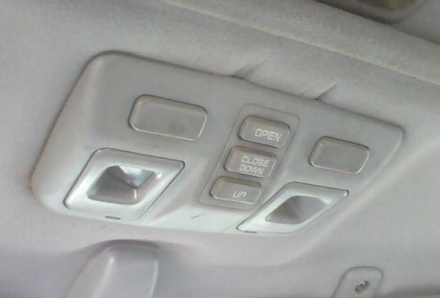

TheLoyale Posted February 11, 2011 Author Share Posted February 11, 2011 Why the hell did they put it right there? Looks odd. Well that blows, you could rig up some aftermarket map light maybe. All the Legacys I have seen with a Sunroof also have a larger headunit which has maplights and window controls on it. I wonder if you can retrofit one of those onto yours. I'm sure the window control connector would be the same, plus with the larger unit, it'll cover up that stain -Tom Link to comment Share on other sites More sharing options...
1-3-2-4 Posted February 11, 2011 Share Posted February 11, 2011 Not sure.. the large button allows the sunroof to stay open with the car off or close when I turn off the car. I never understood the placement of it as well.. Not sure if it works with the factory controls the sunroof is ASC. Link to comment Share on other sites More sharing options...
TheLoyale Posted February 11, 2011 Author Share Posted February 11, 2011 Not sure.. the large button allows the sunroof to stay open with the car off or close when I turn off the car. I never understood the placement of it as well.. Not sure if it works with the factory controls the sunroof is ASC. So the sunroof was an aftermarket application? Link to comment Share on other sites More sharing options...

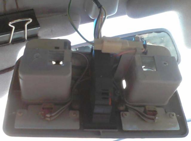

1-3-2-4 Posted February 16, 2011 Share Posted February 16, 2011 man lol you got me wanting maplights but I'm going to be putting in some very bright leds.. just a few questions.. how did you get the headliner down to wire to the center dome light? and Do you think it's possible I can move that sunroof switch? lol i doubt it will work with the subaru switch. Link to comment Share on other sites More sharing options...
heartless Posted February 16, 2011 Share Posted February 16, 2011 i have a first gen legacy with the factory sunroof/maplight controls - i can take some pics or the wiring connections for you if you want... Link to comment Share on other sites More sharing options...
1-3-2-4 Posted February 16, 2011 Share Posted February 16, 2011 that might help Link to comment Share on other sites More sharing options...

heartless Posted February 17, 2011 Share Posted February 17, 2011 (edited) that might help pics are here - sent you a pm - I have the factory wire diagram for this thing if you want it - might help you determine if you can use the switches or not... also note that the area where the maplight housing is mountied is "raised" from its surroundings... (and the dents in the headliner were from some toothpic sized flags...the ones you get from veterans) Edited February 17, 2011 by heartless Link to comment Share on other sites More sharing options...
TheLoyale Posted February 17, 2011 Author Share Posted February 17, 2011 pics are here - sent you a pm - I have the factory wire diagram for this thing if you want it - might help you determine if you can use the switches or not... I bet you could use that switch, if not. Pop that one out and stick in the one you have. Easy. Link to comment Share on other sites More sharing options...
1-3-2-4 Posted February 17, 2011 Share Posted February 17, 2011 (edited) i found what might be a wire diagram for the ASC sunroof but I'd have to see with the Subaru one.. if need be I will move the switch over under the visor since I don't open the sunroof all that much anyways. I mean the switch must be basic.. but has a control to allow it to stay open when the car is off or close when the car is turned off. I want to guess with the map lights you have 12V coming in splitting off to each maplight right? Edited February 17, 2011 by 1-3-2-4 Link to comment Share on other sites More sharing options...
heartless Posted February 17, 2011 Share Posted February 17, 2011 yup, one green wire w/yellow stripe powers in - grounded thru the mounting screws, runs to one light then the other... tom - there is no "popping" the switch out - you could remove the buttons, but that would be it - the surround is solid... wire diagram sent. Link to comment Share on other sites More sharing options...
1-3-2-4 Posted February 17, 2011 Share Posted February 17, 2011 yup, one green wire w/yellow stripe powers in - grounded thru the mounting screws, runs to one light then the other... tom - there is no "popping" the switch out - you could remove the buttons, but that would be it - the surround is solid... wire diagram sent. I guess I can cut and splice in the LED driver after the connection in the roof. As for the ground that might be a little tricky. And for the sunroof I'm sitting here looking at the pdf and I just noticed my switch it has express open and vent options but I think the old school switches did not have express open did they? When I have the courage to take the switch out of the headliner I will take a look at the backside but hmm not too sure now. Also feeling around it seems like the area under the visor is hallow. Link to comment Share on other sites More sharing options...
heartless Posted February 17, 2011 Share Posted February 17, 2011 (edited) I guess I can cut and splice in the LED driver after the connection in the roof. As for the ground that might be a little tricky. And for the sunroof I'm sitting here looking at the pdf and I just noticed my switch it has express open and vent options but I think the old school switches did not have express open did they? When I have the courage to take the switch out of the headliner I will take a look at the backside but hmm not too sure now. Also feeling around it seems like the area under the visor is hallow. no, there is nothing "express" about my sun/moonroof - at least not when sliding it back - the "up" function is pretty quick LOL also, when "closing" from the slid back position - it will close to a certain point, then stop, you have to release the button and hit it again to close fully - some sort of safety thing - they want you to make sure there are no fingers in the way? yeah, there should be some space between the headliner & the metal roof of the car - it will vary by location as to how much. just had a thought - how big is your existing switch housing? - from the pic it doesnt look like it is too big - it might be possible to remove the factory switch and cut/trim the housing to fit your switch in its place? Edited February 17, 2011 by heartless Link to comment Share on other sites More sharing options...
1-3-2-4 Posted February 17, 2011 Share Posted February 17, 2011 no, there is nothing "express" about my sun/moonroof - at least not when sliding it back - the "up" function is pretty quick LOL also, when "closing" from the slid back position - it will close to a certain point, then stop, you have to release the button and hit it again to close fully - some sort of safety thing - they want you to make sure there are no fingers in the way? yeah, there should be some space between the headliner & the metal roof of the car - it will vary by location as to how much. on mine it express opens and closes express meaning no need to press twice like you said.. it will only stop closing if something gets in the way when closing. Link to comment Share on other sites More sharing options...
