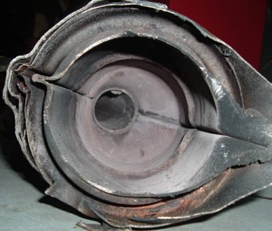

WJM Posted February 28, 2004 Author Share Posted February 28, 2004 And its gutted...LOUD can you say? Link to comment Share on other sites More sharing options...

WJM Posted February 28, 2004 Author Share Posted February 28, 2004 well, as you can see by the pics, ive installed that. It seems to be better down low...but up high its kinds...iffy, kinda unsure of its self. I guess we will see during tomorrow's commute. 28 miles of high speed interstate, followed by 20 miles of intermediate driving. Edit: oh, the PCV system consists of two 5/8" hoses, one from each cam case cover, teed to a single breather filter. The PCV valve plugged, and this SPFI block doesnt have the rear PCV vent, like the proper turbo/mpfi blocks have. Link to comment Share on other sites More sharing options...

scoobie steve Posted February 29, 2004 Share Posted February 29, 2004 Ya man your engine is toast. Knocking out cats will do nothing for that poor engine. Time for another block......maybe a 7.7:1 will last longer this time! Compression on a good engine should be within 10% Link to comment Share on other sites More sharing options...
WJM Posted February 29, 2004 Author Share Posted February 29, 2004 Yeah, seems like it. Its being all wishy washy...sometimes its got power, sometimes it doest. It acts like the Vac advance is not working too...that was an all of a sudden thing since the snow got put on the ground. Adn the vac adv. is hooked up...maybe clogged? arg. Anyhow, that exhaust to way too loud for this neighborhood...time to fix that other exh, and put it back on....and change tires. i dont need no sticking 175/80/13 snow/mud grippers now! Back to the 205/60/13 ultra grippy Tarmac tires! I just need for it to hold together until i get the DL on the road...one more week...hold together... Link to comment Share on other sites More sharing options...
