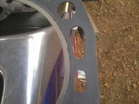

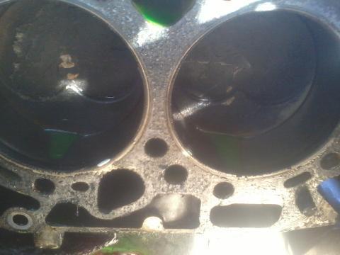

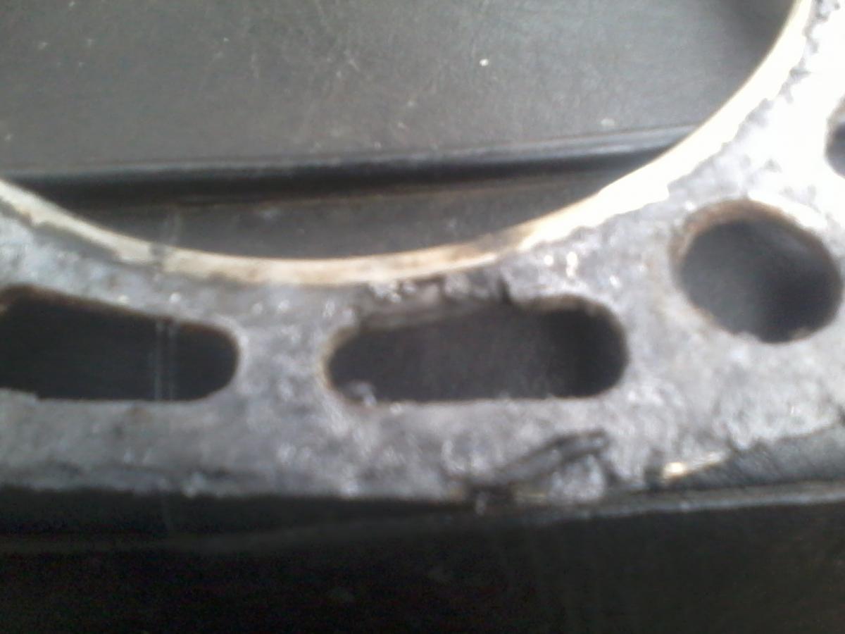

Len Dawg Posted February 17, 2017 Share Posted February 17, 2017 (edited) FelPro Failure... maybe 60k miles marked in white failed.. I got OEM this time.. The new oem has a tab that wraps around from the ring to where it would fail.. suppose somebody did their homework at subaru... And thanks again for the support from members of USMB!!! Edited February 17, 2017 by Len Dawg Link to comment Share on other sites More sharing options...
