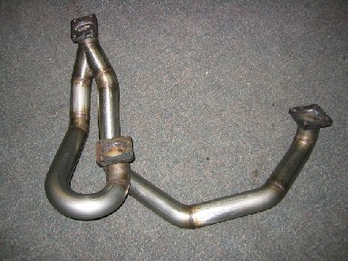

Marck Posted March 16, 2004 Share Posted March 16, 2004 Are there any pics of the crossover pipes or downpipes that we can drool over. I can't wait. Link to comment Share on other sites More sharing options...
garner Posted March 16, 2004 Share Posted March 16, 2004 drool over this Link to comment Share on other sites More sharing options...
WJM Posted March 16, 2004 Author Share Posted March 16, 2004 WOW. but the pic names says ej18t ss header02cc? I dont remember EJ18s haveing single exh ports... Link to comment Share on other sites More sharing options...
garner Posted March 16, 2004 Share Posted March 16, 2004 WJM, That's techworks photo from the first post on these. remember the engine code confusion? It is the crossover pipe thou art coveting Link to comment Share on other sites More sharing options...
WJM Posted March 16, 2004 Author Share Posted March 16, 2004 Cool. Remember any pics for a DP? Link to comment Share on other sites More sharing options...
garner Posted March 16, 2004 Share Posted March 16, 2004 i never saw pics of a down pipe but they must have had one with that turbo. I'm going to use a gutted and modified (bell mouthed) stock wrx down. $25 on ebay plus a few hours of cat gutting Link to comment Share on other sites More sharing options...
Marck Posted March 16, 2004 Share Posted March 16, 2004 Cool. Why is the header 'close to equal length' instead of 'equal length'? Link to comment Share on other sites More sharing options...
rallyruss Posted March 16, 2004 Share Posted March 16, 2004 check out the pic. its alittle shorter on the pass. side. if it were true equal length it would be a bit large to fit. WJM will they make different flages for different types of turbos like say a vf11:slobber: Link to comment Share on other sites More sharing options...
carfreak85 Posted March 16, 2004 Share Posted March 16, 2004 I talked to the TWE guy who is on the board and he said that they are not quite equal length, but really darn close. Also, if one pipe it 2x longer than the other, it would have the same effect as an equal lenth pipe. Link to comment Share on other sites More sharing options...
