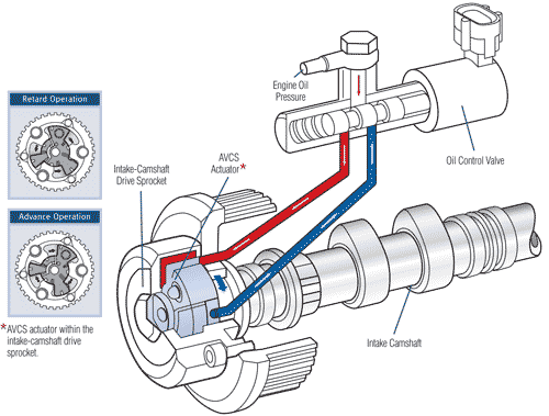

subaruplatt Posted July 21, 2010 Author Share Posted July 21, 2010 Thanks GeneralDisorder ! Do you have a good illustration of the valve train so I may understand it better? I am also interested in learning how the simple v-teck works in these engines. Even though I am going a bit overboard in this situation the new belt and plugs will give me peace of mind. Thanks Quote Link to comment Share on other sites More sharing options...
AWDfreak Posted July 22, 2010 Share Posted July 22, 2010 Thanks GeneralDisorder !Do you have a good illustration of the valve train so I may understand it better? I am also interested in learning how the simple v-teck works in these engines. Even though I am going a bit overboard in this situation the new belt and plugs will give me peace of mind. Thanks In Honda nomenclature, it's spelled "VTEC", I don't understand why that's so hard to spell. :-\ In the world of Subaru, it's AVCS, or "Active Valve Control System". To be honest, I've never taken a close look of Subaru's variable valve timing, only at some Honda and Fiat designs. But I do know that a large majority of variable valve timing mechanisms work through oil pressure. Correct me if I'm wrong. Glad to know it worked out though. Quote Link to comment Share on other sites More sharing options...

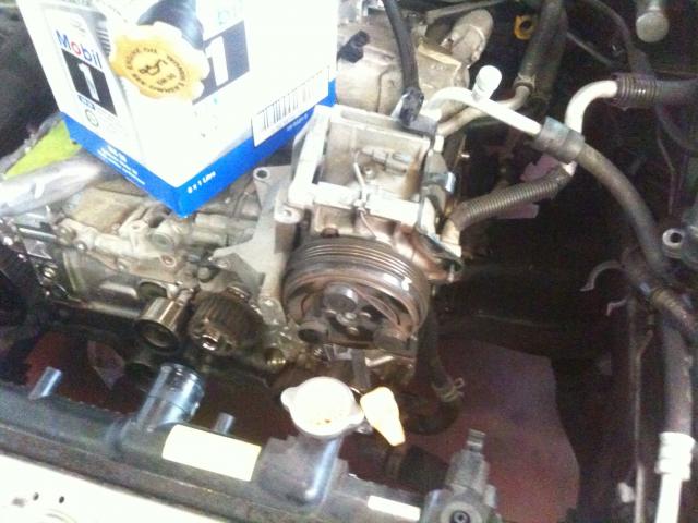

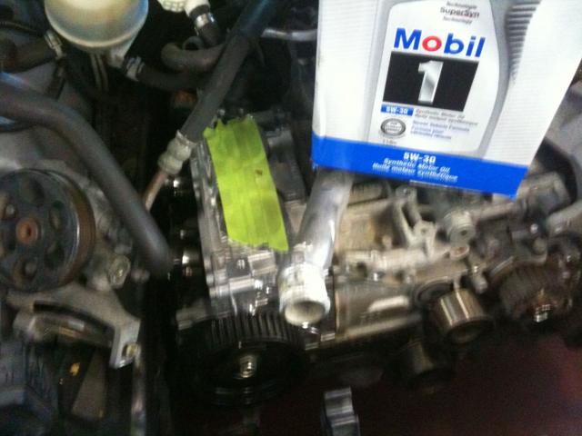

subaruplatt Posted July 23, 2010 Author Share Posted July 23, 2010 Here are two pictures of the work in progress. So far the left head is mostly completed. I got a recent model forester as a replacement. Quote Link to comment Share on other sites More sharing options...
GeneralDisorder Posted July 23, 2010 Share Posted July 23, 2010 Based on the pictures that would be the "right" head. Right/Left is always as if you were sitting in the car. Looks good thus far. I'm surprised they didn't pull the engine - makes head gasket type work a lot easier. But then I hate bending over an engine bay - kills my back. GD Quote Link to comment Share on other sites More sharing options...

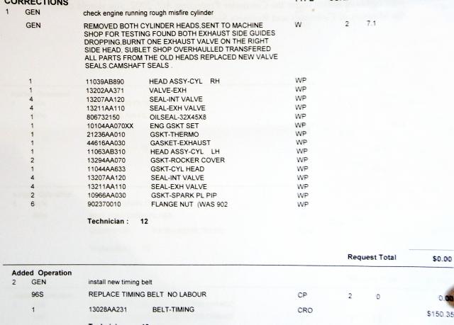

subaruplatt Posted July 25, 2010 Author Share Posted July 25, 2010 (edited) Got the car back and the engine is running smoothly. Idle is low and the engine is quiet. I am going to attach a parts summary. These are the part numbers subaru canada chose for an 06 impreza wagon auto. Edited July 25, 2010 by subaruplatt Quote Link to comment Share on other sites More sharing options...
subaruplatt Posted August 1, 2010 Author Share Posted August 1, 2010 Just thought I might do a follow up. The newly reassembled engine is running beautifully and now has over 200KM running at various city speeds. The AVCS seems much smoother, before it would just kick in, in an on and off manner. Now it seems to operate progressively and is a transparent part of RPM. The engine is pulling stronger at 1500 rpm. So even though the transmission doesn't always downshift the car is bogging less. The only thing i notice is a very slight stumble on take off some times, but this isn't a problem goes away when warmed up. I read that if your valve clearances are on the tighter side that's what you get. The engine sounds like it loosens up after it is good and warmed up. There are zero leaks:banana: REMOVED BOTH CYLINDER HEADS,SENT TO MACHINE SHOP FOR TESTING FOUND BOTH EXHAUST SIDE GUIDES DROPPING.BURNT ONE EXHAUST VALVE ON THE RIGHT SIDE HEAD. SUBLET SHOP OVERHAULLED TRANSFERED ALL PARTS FROM THE OlD HEADS REPLACED NEW VALVE SEALS CAMSHAFT SEALS What does this all mean why it happened I will never know. ? Just hopefully it wont happen again. Quote Link to comment Share on other sites More sharing options...

subaruplatt Posted February 14, 2011 Author Share Posted February 14, 2011 I noticed that the 10104AA070XX ENG GSKT SET is not a part I found listed for my 06 impreza wagon. http://www.dealerdirectparts.com/2004-SUBARU-FORESTER-X-Engine-Cylinder-Hea-p/subaru-5746980-for-x-4.htm But according to opposed forces http://opposedforces.com/parts/impreza/us_g11/type_27/engine/engine_gasket_and_seal_kit/illustration_3/ I should have 10105AB020 GASKET & SEAL KIT https://content.subarunet.com/snet/_content/fixed_operations/parts_quick_reference_guide/Pg%2072-74.pdf Below is a list of the parts installed last year. What is the difference between the recommended 10105AB020 GASKET & SEAL KIT and the 10104AA070XX ENG GSKT SET I got ? Bellow is the list of parts. 11039AB890 HEAD ASSY-CYL RH 13202AA371 VALVE-EXH 13207AA120 SEAL-INT VALVE 13211AA110 SEAL-EXH VALVE 806732150 0ILSEAL-32X45X8 10104AA070XX ENG GSKT SET 21236AA010 GSKT-THERMO 44616AA030 GASKET -EXHAUST 11063AB310 HEAD ASSY -CYL LH 13294AA070 GSKT-ROCKER COVER 11044AA633 GSKT-CYL HEAD 13207AA120 SEAL-INT VALVE 13211AA 110 SEAL-EXH VALVE 10966AA030 GSKT -SPARK PL PIP 902370010 FLANGE NUT (WAS 9 2 Technician: 12 install new timing belt REPLACE TIMING BELT NO LABOUR 13028AA231 BEL T-TIMING Quote Link to comment Share on other sites More sharing options...
