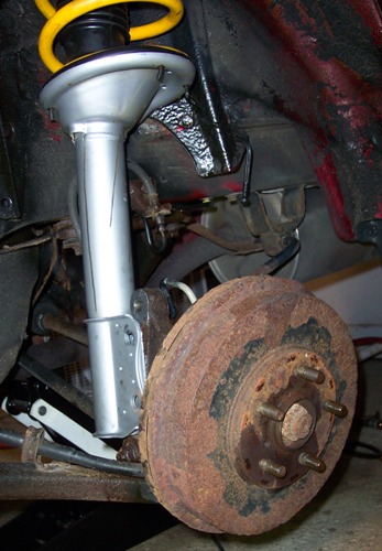

porcupine73 Posted August 7, 2010 Share Posted August 7, 2010 Just some pics for reference for future readers of the thread left: McPherson . right: multilink Quote Link to comment Share on other sites More sharing options...
