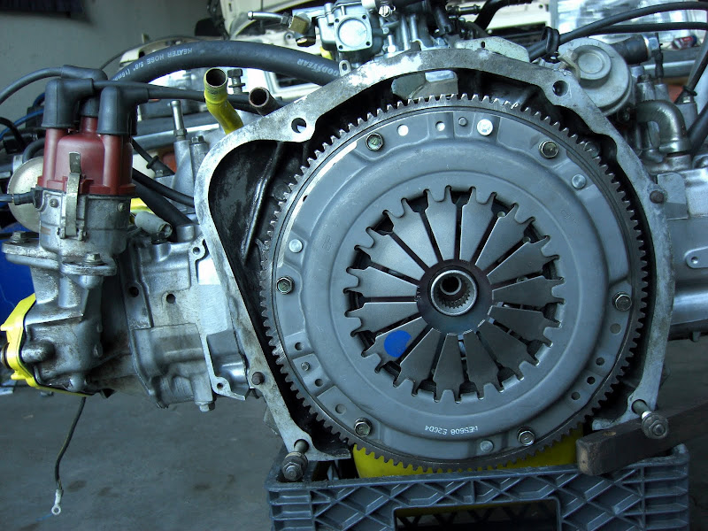

kanurys Posted September 19, 2010 Author Share Posted September 19, 2010 cmiller said: Looks good Sesh! Now drop that mutha in!! Done with the engine. Now all I have to do is change the oil. It sits right at 200 degrees F and oil pressure is good. I know you guys hate pictures: Link to comment Share on other sites More sharing options...

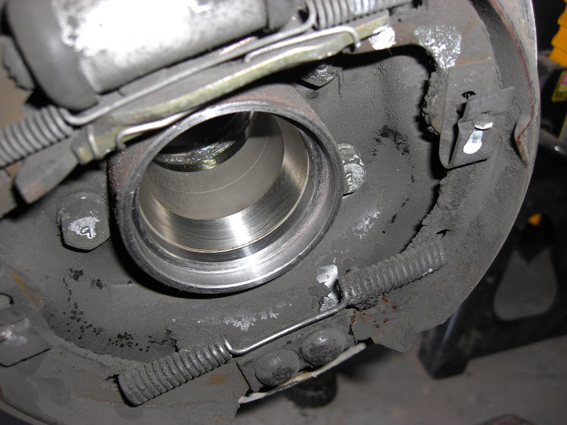

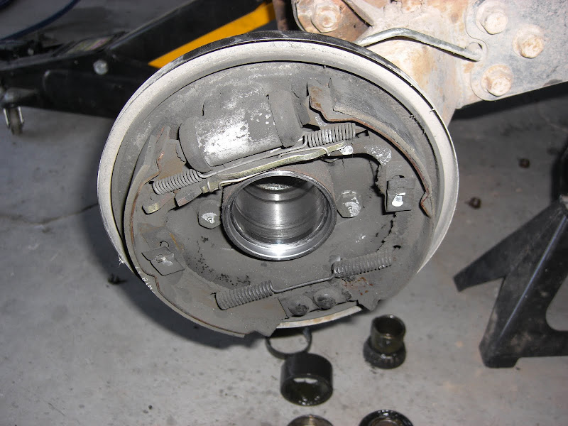

kanurys Posted September 19, 2010 Author Share Posted September 19, 2010 (edited) Now it's rear wheel bearing time: Packed with marine bearing grease (for those water crossings, and fertilizer resistant!). Edited September 19, 2010 by kanurys Link to comment Share on other sites More sharing options...

kanurys Posted September 21, 2010 Author Share Posted September 21, 2010 I've used many varieties of grease. I started using this synthetic stuff (0-500 f) in Oregon for wheel bearings since it was always so wet. It seems to hold up the best. When you open it up, again, the grease is usually still in good shape, where as a lot of molly grease degrades a bit more quickly. Link to comment Share on other sites More sharing options...

987687 Posted September 22, 2010 Share Posted September 22, 2010 Awesome job! that engine is so clean! kanurys said: Now it's rear wheel bearing time: We should have a thread devoted to nasty wheel bearings... I have some to keep yours company. Link to comment Share on other sites More sharing options...

kanurys Posted September 27, 2010 Author Share Posted September 27, 2010 (edited) you saw my shinny bearing. I cleaned up the inner and outer bearing sleaves and kept them for who knows what. Anyways, I have about 45 miles on the rebuilt engine and it seems real happy. I have a little coolant leak at the base of the carb (grrrrr) so I guess I'll attack that guy and it should be all buttoned up. Thanks again for everyone's help. I'll post more when it's lift time. Edited September 27, 2010 by kanurys Link to comment Share on other sites More sharing options...
