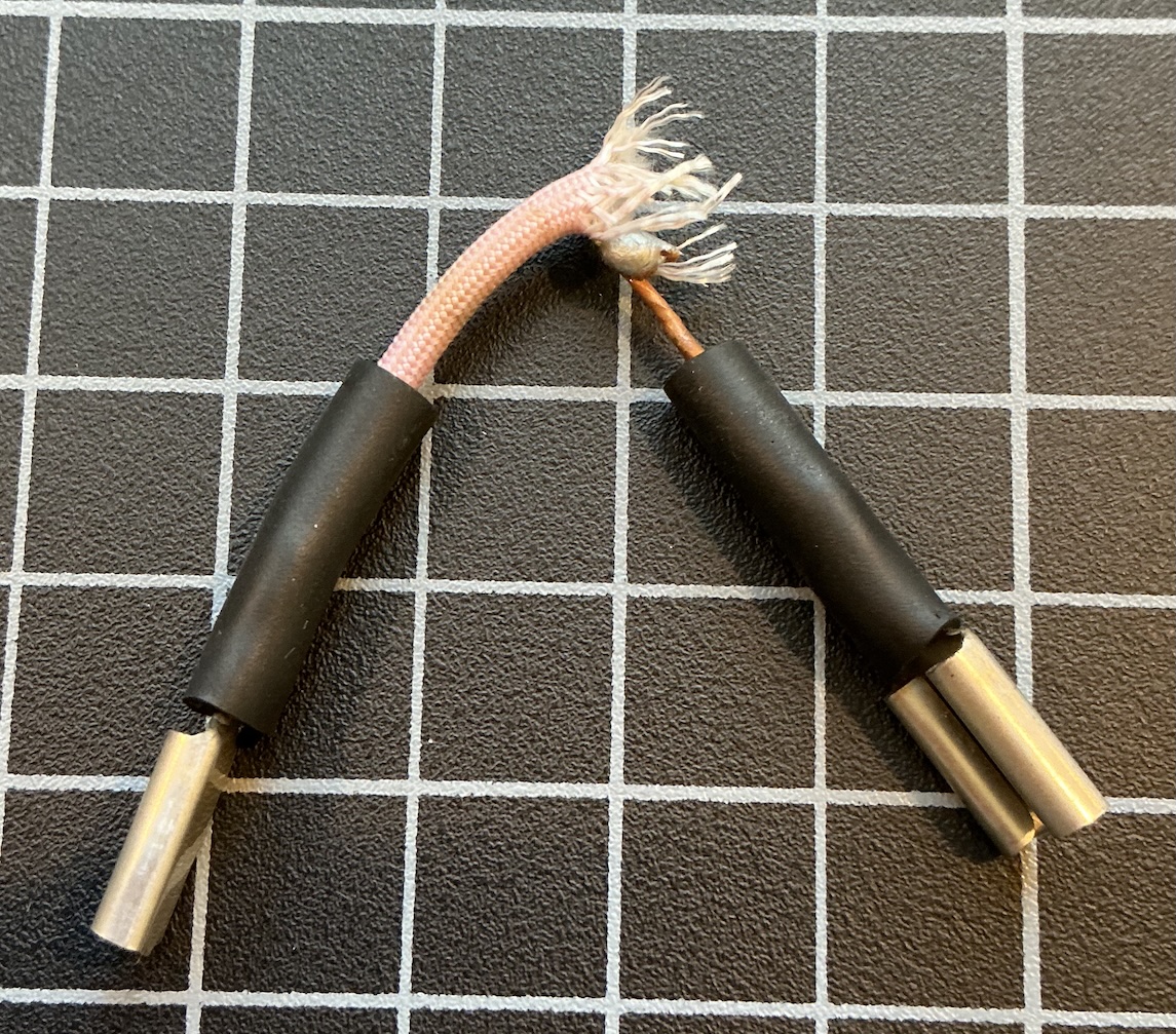

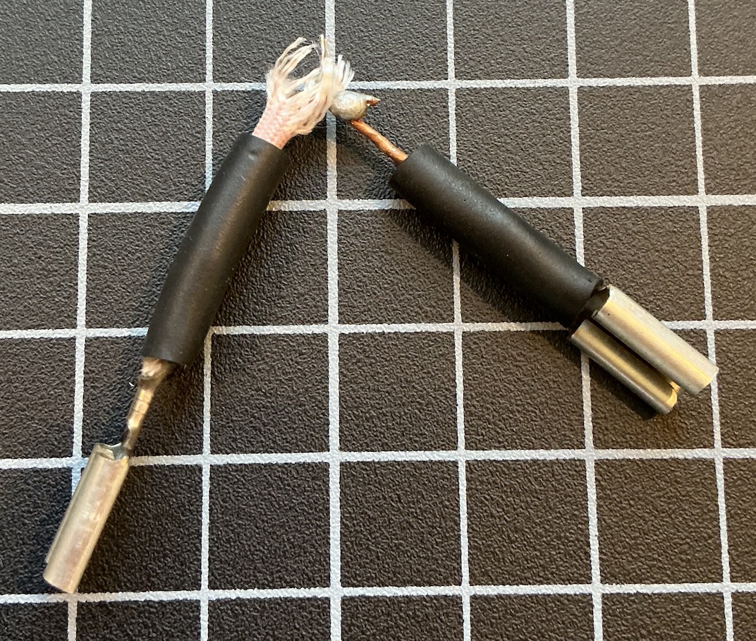

ebarb Posted January 17 Share Posted January 17 (edited) zombie thread, but while chasing down a blower motor issue I came across your mention of a "white" fusible link. I had one that the PO soldered back together and the fabric on it was almost entirely white. I pushed down the rubber jacket and you can see the red a little more. Edited January 17 by ebarb replacing with jpegs Link to comment Share on other sites More sharing options...
