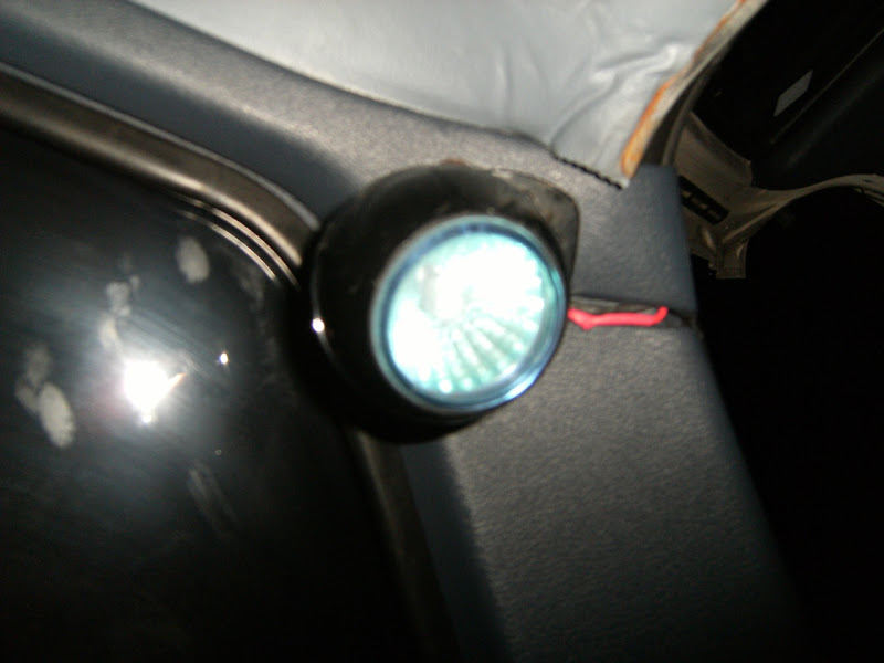

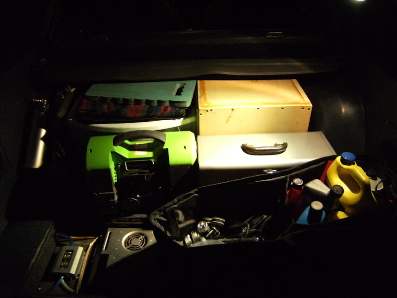

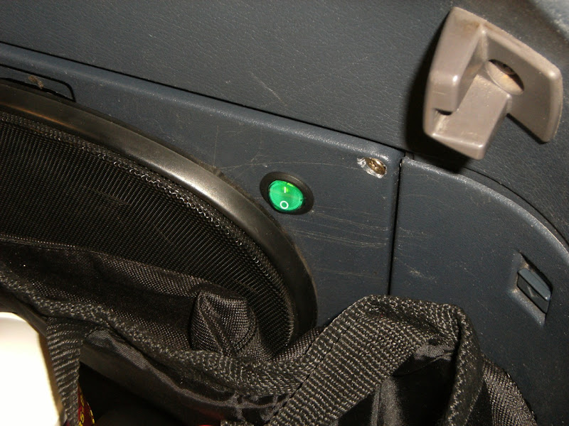

eulogious Posted September 2, 2010 Share Posted September 2, 2010 Hello all, So I got tired of not having any light in the cargo area of my 1990 T-Wagon, so I decided to do something about it. My first idea was to just get the rear light for my wagon that came stock. Yes, this would add more light in the back, it would still only add a little bit of light, not enough that it would make me happy. So I decided to go another route. I happen to have a set of cheapy fog lights that were used and given to me by a friend. I have no real use for these, so I decided that I would sacrifice one of them and mount it in my cargo area of my wagon. I also happen to have a relay kicking around as well as an inline fuse and a lighted switch, so I had everything needed to make this happen. So after a couple of hours of messing around with mounting the switch and the light it's self, I had success! Lucky for me, I already had a great power supply in the back, my stereo equipment! So I tapped into the power, wired in the relay, mounted my switch and the light, and presto! TONS of light in the back now Here's some pics: This is before in the dark with just the dome light on in the car: Pretty dark. This is the same area, just taken with the light on: Big difference! Needless to say, I like it alot. Since I work at night, most of my time is spent at night in the dark, so this will really help me out. I no longer have to fumble around till I find my flashlight in order to see in the back! Here's some more pics of where I mounted my switch and the light. I used a lighted switch, I figured that it would be easier to see at night, so why not? I mounted the light on the passenger side, sideways, so that it would light up close to the middle of the back: I left the wires out for movement room, because I can rotate the light to face out the back if I would like, so this gives me a little bit of clearance to move the light. Here's a pics with the cover over it so you can see where the light hits: The one thing I noticed is that the light gets HOT. So I just need to be careful to not leave the thing on for extended periods of time, it will get very hot. But other than that, it's great having a light in the back that actually lights up everything back there at night, I love it! I just thought that I would share Quote Link to comment Share on other sites More sharing options...
