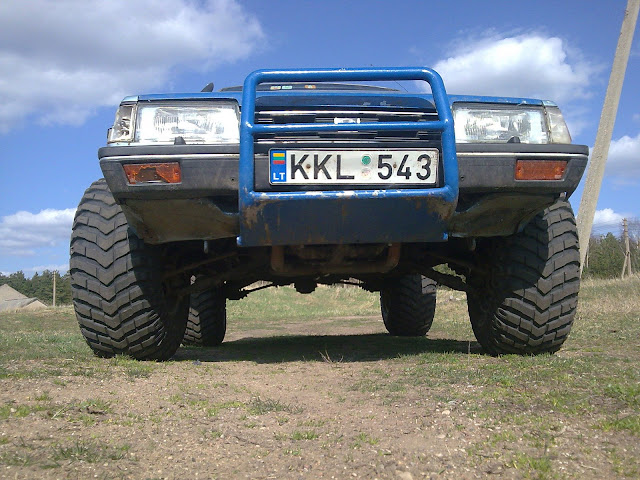

Uberoo Posted May 31, 2011 Share Posted May 31, 2011 might need a bit of clearancing.those tires look like they might rub a little on the inside..zzz what size tires are those? Quote Link to comment Share on other sites More sharing options...
TommyH Posted May 31, 2011 Author Share Posted May 31, 2011 might need a bit of clearancing.those tires look like they might rub a little on the inside..zzz what size tires are those? They are well worn Maxxis Mudzilla LT 33x13.50-15 I might have to get rid of the back doors Front wheels are rubbing on lower spring plate. 2" spacers will fix that problem... Quote Link to comment Share on other sites More sharing options...

TommyH Posted September 2, 2011 Author Share Posted September 2, 2011 Nothing new really... Gearing was way off with mudzillas so i bought set of used 235/75-15 Bfg At's. Planning to try them out this weekend with hopefully not so much smoke from clutch ...might have to cut/regroove tires for better offroad/mud traction. Quote Link to comment Share on other sites More sharing options...
