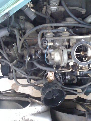

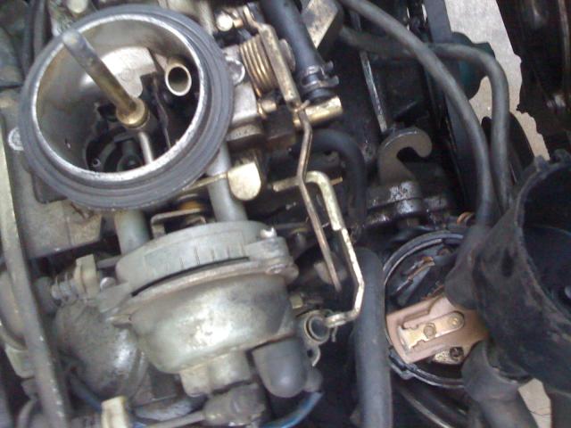

turbo5speedgl Posted September 30, 2010 Author Share Posted September 30, 2010 they check under the hood. heres a pic or the timing its at 8 degrees btdc and the rotor is pointing at the #1 cyclinder but should it point at the top of the spark plug or no. and the second pic what is the goldish circle thing below the carb opening because its loose and turns both ways. Link to comment Share on other sites More sharing options...
