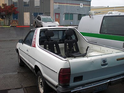

Can someone please indulge me with a photo of the OEM frame and mounts? Mine is an '86 that did not come with the seats and I am trying to fab up a frame to put them in. A picture would make it a lot easier to get right on the first try. Google has not been fantastically helpful as this is a rather obscure request.
Bonus points for seatbelt and head rest mounting also!!

IMGA1116.jpg?t=1288388644IMGA1115.jpg?t=1288388644
IMGA1114.jpg?t=1288388644
IMGA1113.jpg?t=1288388644
