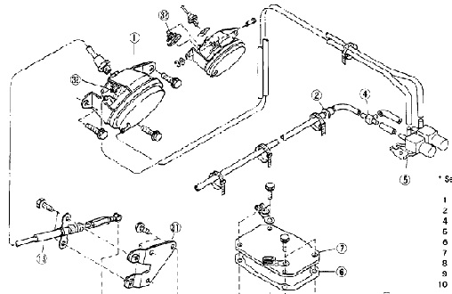

mountain brat Posted November 2, 2010 Share Posted November 2, 2010 anyone have a schematic of xt6 trans wiring i swapped one into my 85 gl. its a manual and the schematic of the diff lock system i think its easy but running out of time and need to get it done thanks a bunch justin Link to comment Share on other sites More sharing options...
idosubaru Posted November 2, 2010 Share Posted November 2, 2010 just to be sure, there isn't any wiring at the trans for the diff lock, so do you mean wiring for the trans or wiring for the diff lock controls? i think that's what you mean? there's wiring for the solenoids that control vacuum flow to the actuator which essentially just pushes and pulls the mechanical linkage on the side of the trans. do you have the actuator? (large round disc shaped gizmo). as long as you have the large disc shaped actuator you just need to provide vacuum to that in order to activate the diff lock. you can literally pull any vacuum hose and attach it to that actuator to engage the diff lock. so - you just install a solenoid that is activated by your diff lock switch that essentially controls the vacuum to the actuator. Subaru Xt factory service manuals are hosted in full for free, you can find the link at subaruxt.com. i attached a pic from the FSM of the actuator, solenoid that controls it (which is what needs wired in to the switch), etc. Link to comment Share on other sites More sharing options...

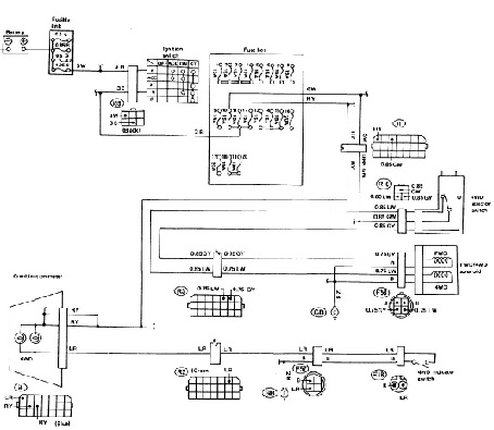

idosubaru Posted November 2, 2010 Share Posted November 2, 2010 here's the actual electronics for the 4WD MT control. but i don't think the size limits permit clarity and i've already spent enough time fooling with it. Link to comment Share on other sites More sharing options...
mountain brat Posted November 3, 2010 Author Share Posted November 3, 2010 right on thanks gary,i was wanting the schematic for both the diff lock and the trans itself theres two plugs on it Link to comment Share on other sites More sharing options...
