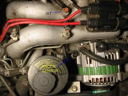

hb_kim Posted March 10, 2004 Share Posted March 10, 2004 I am trying to locate IAT sensor and knock sensor. Is this correct? Of course, it would make much more sense if blitz can upload the pic of the knock sensor & IAT fixes. Thanks in advance! Link to comment Share on other sites More sharing options...
hb_kim Posted March 10, 2004 Share Posted March 10, 2004 IMG didn't seem to work. Trying "attach file" option. Link to comment Share on other sites More sharing options...
99obw Posted March 10, 2004 Share Posted March 10, 2004 I think the thing you have labeled IAT is a ground, and the thing you have labeled knock sensor is the oil pressure sensor. Link to comment Share on other sites More sharing options...
intrigueing Posted March 10, 2004 Share Posted March 10, 2004 Picture of the KS, I believe the IAT is on the intake near the air filter.... http://www.main.experiencetherave.com:8080/subaru/images/injectors/DCP_2481.JPG Link to comment Share on other sites More sharing options...
