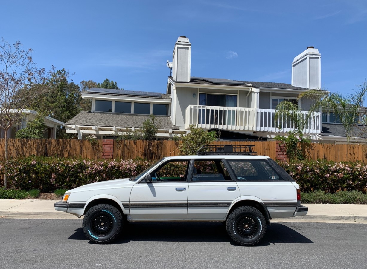

cartwheels Posted April 12, 2021 Share Posted April 12, 2021 27x8.5 R14 General Grabber ATX with a 2" ADF lift kit 2 Link to comment Share on other sites More sharing options...

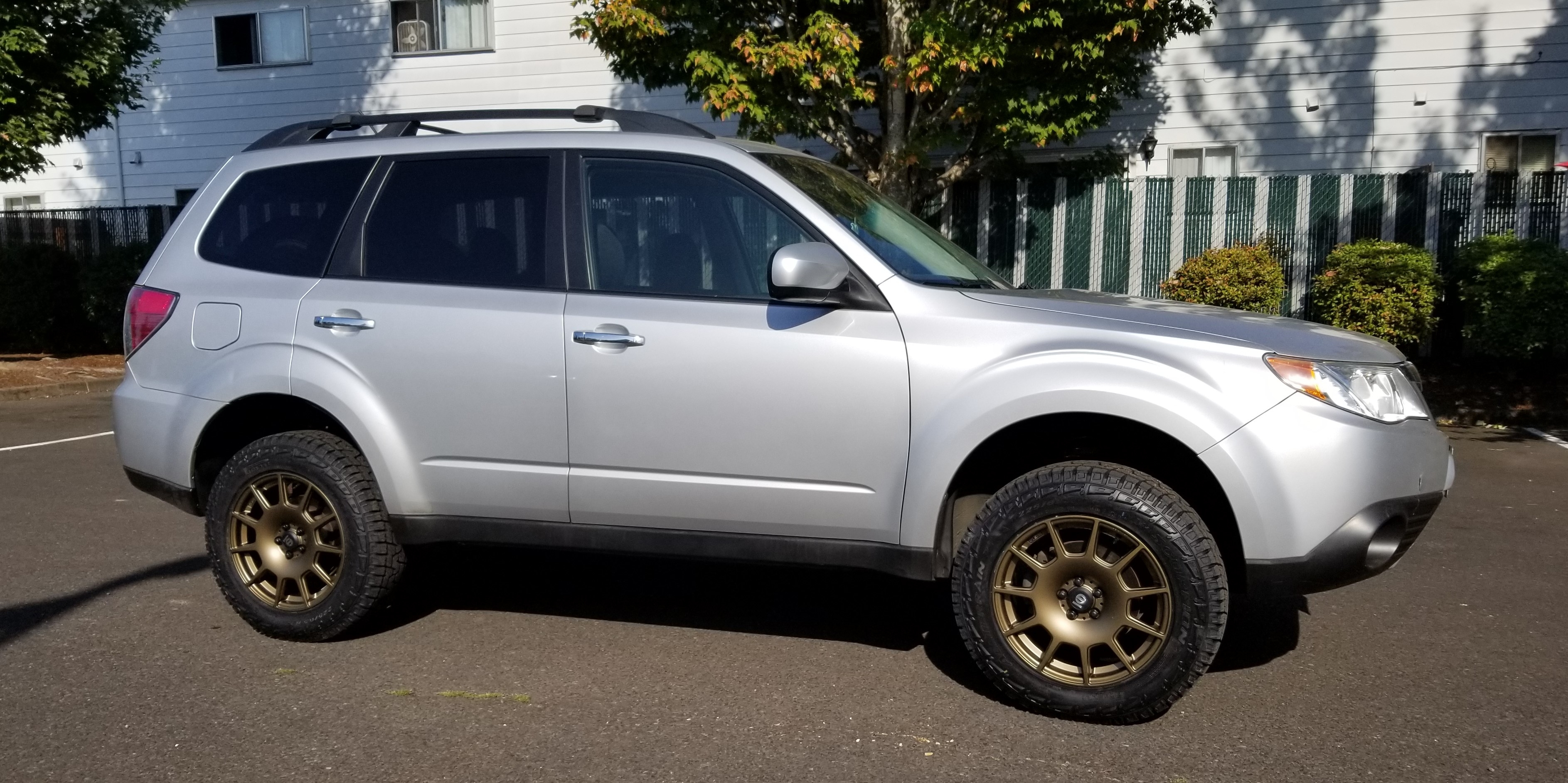

Malibu80 Posted August 23, 2021 Share Posted August 23, 2021 (edited) 2011 Forester 2.5X Prem, Anderson 2" lift with multi-link spacers, King Springs. Sparco Terra 17" x 7.5" +48 , Pirelli Scorpion All-Terrain Plus , 225/65R17. No trimming needed, no rubbing. Edited August 23, 2021 by Malibu80 1 Link to comment Share on other sites More sharing options...
dameson Posted September 8, 2021 Share Posted September 8, 2021 On 8/23/2021 at 5:07 PM, Malibu80 said: 2011 Forester 2.5X Prem, Anderson 2" lift with multi-link spacers, King Springs. Sparco Terra 17" x 7.5" +48 , Pirelli Scorpion All-Terrain Plus , 225/65R17. No trimming needed, no rubbing. Expand How's the off-road performance of the Scorpion AT Plus? I saw them on 4wheelonline while looking for new tires online. I like them because their tread design is not too aggressive. Link to comment Share on other sites More sharing options...
