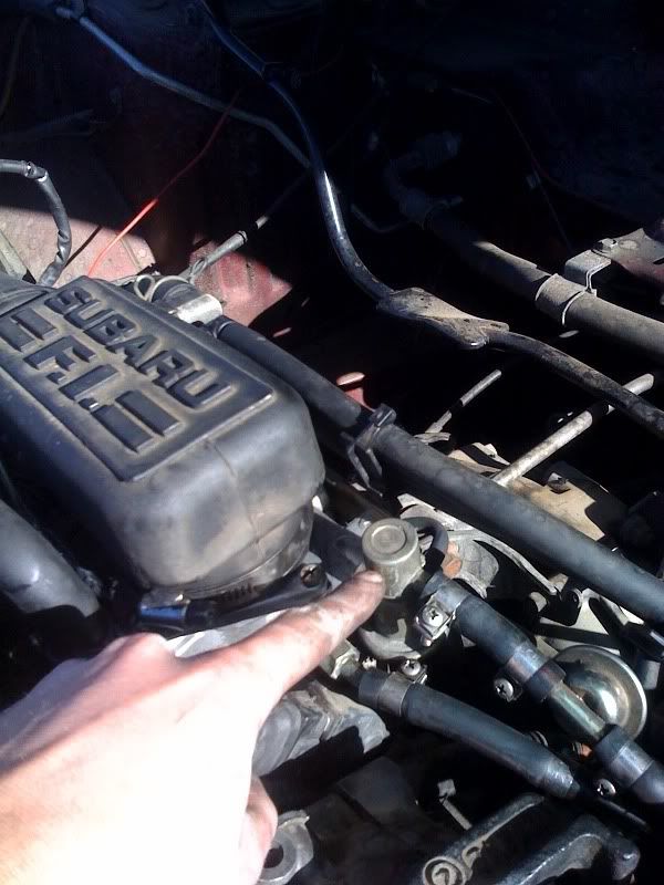

zaniusmaximus7 Posted November 26, 2010 Author Share Posted November 26, 2010 I hope this picture uploads. Anyway, There seems to be a broken ground of some sort that I'm pointing to with the tip of the screwdriver. What is this and what is the whole part called?? Also, I went and disconnected the fuel lines that go to the TBI??? The upper one squirted fuel, and I'm assuming the lower one isn't a pressurized line because nothing came out. Still wouldn't start.... Blehhhhh Quote Link to comment Share on other sites More sharing options...

Deener Posted November 26, 2010 Share Posted November 26, 2010 Your screwdriver is right next to the Idle Air Control valve. Hard to tell but it looks like your screwdriver is pointing to it's wire. Not sure if that would cause your issue or not. Sounds like your fuel pump is working though... Quote Link to comment Share on other sites More sharing options...

naru Posted November 26, 2010 Share Posted November 26, 2010 Fix that wire! Quote Link to comment Share on other sites More sharing options...
zaniusmaximus7 Posted November 26, 2010 Author Share Posted November 26, 2010 Haha I knew that wasn't supposed to be like that. K so shoot I'd better figure out where it goes. But now with it not starting and all....gahhhh why do I always have to tear crap apart. Quote Link to comment Share on other sites More sharing options...
zaniusmaximus7 Posted November 26, 2010 Author Share Posted November 26, 2010 K so in the midst of cleaning stuff, I managed to stick my Q-tip where it doesn't belong (har har har). The car isn't getting fuel because the little gold part is plugged up. This is the piece that the fuel lines connect to. I have no idea what it's called or how to order it. http://i1107.photobucket.com/albums/h398/zaniusmaximus7/Otherthing.jpg As far as the broken off wire goes, isn't this just a ground? Can I just butt splice some wire to it and ground it or does it actually go somewhere?? Also, Im extremely happy with you guys and your prompt responses. I appreciate it BIG TIME. Thank you fellas, seriously. Quote Link to comment Share on other sites More sharing options...
Deener Posted November 26, 2010 Share Posted November 26, 2010 Someone correct me if I am wrong but I think thats a fuel damper. It is supposed to smooth out pulses during fuel delivery. Do a search here for fuel damper. I don't know what the wire does, I assume it is for the IAC but maybe someone else that knows can chime in...? Quote Link to comment Share on other sites More sharing options...
naru Posted November 26, 2010 Share Posted November 26, 2010 K so in the midst of cleaning stuff, I managed to stick my Q-tip where it doesn't belong (har har har). The car isn't getting fuel because the little gold part is plugged up. This is the piece that the fuel lines connect to. I have no idea what it's called or how to order it. http://i1107.photobucket.com/albums/h398/zaniusmaximus7/Otherthing.jpg As far as the broken off wire goes, isn't this just a ground? Can I just butt splice some wire to it and ground it or does it actually go somewhere?? Also, Im extremely happy with you guys and your prompt responses. I appreciate it BIG TIME. Thank you fellas, seriously. That is the fuel pressure regulator.They don`t normally plug up.Q-tips? Not sure if that is a ground wire or not. Quote Link to comment Share on other sites More sharing options...
zaniusmaximus7 Posted November 26, 2010 Author Share Posted November 26, 2010 Yea I was cleaning everything with Q-tips and now that thing is clogged. So thats the fuel pressure regulator? Alrighty, and I'll just try to groung that wire and see what it does... Quote Link to comment Share on other sites More sharing options...

Ricearu Posted November 30, 2010 Share Posted November 30, 2010 if you clogged the fuel pressure regulator, then that is why there is no fuel. Some hobby tweezers might help with this. Fix the broken wire in the idle air control valve, It is really hard to tell where it goes but if you give me more details on the wire, I can go look at my GL which is an 88 and has spfi Quote Link to comment Share on other sites More sharing options...
zaniusmaximus7 Posted December 2, 2010 Author Share Posted December 2, 2010 That wire is a piece that is bolted onto the IAC with two bolts located on the mid-left side of the module. It looks like the male end of a connector and I'm missing the female side/entire wire. It's that little black "u" looking piece in the picture. Hmmm, now that I look at it, it could just be a retainer clip..... K I'm gonna go take a CLOSER closer look. Quote Link to comment Share on other sites More sharing options...
zaniusmaximus7 Posted December 2, 2010 Author Share Posted December 2, 2010 Again, I really appreciate you guy's help. I checked it out....I think it very well may be a retainer clip:-\ If anyone could verify that it would help loads. Quote Link to comment Share on other sites More sharing options...
