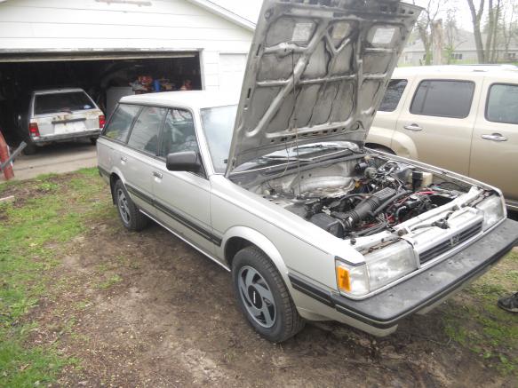

TomRhere Posted November 27, 2010 Share Posted November 27, 2010 (edited) ( had to edit pic as original didn't work no more) This is the Wagon I picked up 11-20-10.Got's lots of work to do to get it back on the road, but I'll get r done.Good clean body, way better than anything I could get around these parts.Not sure of what engine I have here that will wind up in it, just know it will have the D/R 5-speed in it.Got everything here to do an XT6 5-lug swap on it, so thinking that will happen.Played around out in the garage today to make room for it. I'm way that it actually fits and I can walk around it.Now, just waiting for parts to get here for my heater so I can be toasty warm wrenching on it. But I'll do some playing with it until then, just not much....One thing I'm POed at myself for doing, is getting rid of the '88 GL10 FWD Wagon we had here, before I got this one home. I find I be needing things that I could've snagged from it. Oh well, "stuff occurs"!!!! I'll make do in the meantime.Major Kudo's to boxerbob for allowing me to get this from him for "FREE"! Edited February 17, 2013 by TomRhere 1 Link to comment Share on other sites More sharing options...

TomRhere Posted April 1, 2012 Author Share Posted April 1, 2012 Still not on the road. But,,,,,,,, I have; done a rough frontend alignment, sandblasted the rims, and painted them, stretched the tires over the rims, with new valve stems, and inflated them, mounted them on the Wagon, tightened the stub axle bolts on the rear diff, installed axles, filled the diff with slippery stuff, got her down off the jackstands. Fired her up, backed her out of the garage. Took the garden hose and sprayed off 16 months worth of dust... She looks good sitting out in the driveway now. Really thinking that I'm going to pull the EA81 out, and put the EA82 from the '92 Loyale parts Wagon back in it's place. There is definetly something amiss inside the engine..... Besides the knock I can't locate source of, there seems to be issues with the valves sticking. Idle quality sucks, it's all over the place, and will drrop down enough that the engine dies.. Pretty sure it's not from a vac leak as I've checked every vac line, and intake manifold gasket or fitting. There's a putt,putt,putt from the exhaust that shouldn't be there. And if I hold a piece of paper up to the tailpipe, it draws the paper into the pipe each time one of the putts happen, that be a sticky valve or two.... If I can figure out the source of the knock noise, maybe I'll leave the engine in and drive it a bit, just to see if things clear up. It has sat for some 7 years now, so,,,,,,???? But, she runs, and can be driven around the yard. Link to comment Share on other sites More sharing options...
