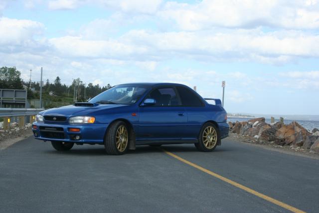

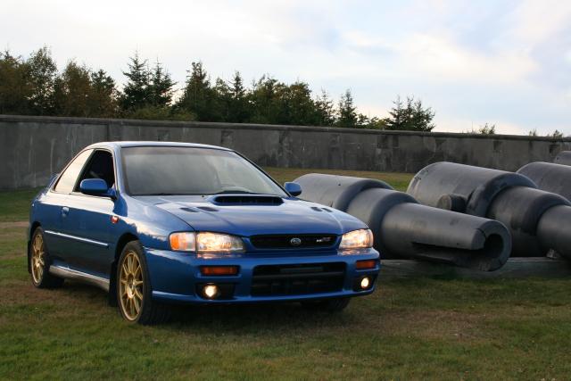

lushy Posted December 18, 2010 Author Share Posted December 18, 2010 I made a break through tonight! last week I traced those ground wires and found one was cut, so I got them all re connected but it didn't fix my problem. So, determined that I had figured out all of the wiring, I went out on a limb and bought another front oxygen sensor and VOILA, so more lights! thanks for all the help, esp OB99W. Here are a couple pictures of my project for your viewing pleasure! Link to comment Share on other sites More sharing options...
Fairtax4me Posted December 18, 2010 Share Posted December 18, 2010 Glad to hear you found the problem! Car looks great! Are those some kinda huge canons in the background?! Link to comment Share on other sites More sharing options...
lushy Posted December 18, 2010 Author Share Posted December 18, 2010 Yeah, that picture was taken at a WW2 military fort that looks over the Halifax harbour in Nova Scotia. Link to comment Share on other sites More sharing options...
