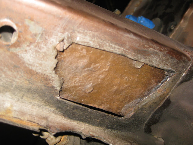

MilesFox Posted April 26, 2011 Author Share Posted April 26, 2011 I got the framerail on the one side of the 3door 95% finished and then i ran out of wire. I forgot to take a picture. I think i have radiation sickness form the uv and xrays. I cut my helmet down to handheld and replaced the lens. And with spare tims, my welds are much better now. I made my tools portable, and now i can brek down the control arms in my backyard and degrease them, por15 them in the rusty parts, and paint hte rest chassis black, available in the can at napa. I am using a zink weld-thru prime as illustrated in a particular u-tube series on bodywork. I am together enogh i can mount the radius rod plate to the body. I am debating to do all the seam welds, and instead of welding on the edges, i am thinking f spot welding between the spots, for more penetration and a cleaner look. I am going to seam weld the radius rod plate body tampings, trans mount stamping, pitch bar mount, and around the strut towers. I may go down the whole trans tunnel. I will have to treat surface rust along the trans tunnel, and mount the xt6 shifter before installing the trans. I may go with mounting the trans, mount, and pitch bar to the body before installing the engine crossmember __________________ Link to comment Share on other sites More sharing options...

TheLoyale Posted April 27, 2011 Share Posted April 27, 2011 Wow, thats some qaulity work. Outstanding Link to comment Share on other sites More sharing options...
Numbchux Posted April 27, 2011 Share Posted April 27, 2011 wow, nice. wish I knew someone up here that could do that quality rust repair. I'm going to have a very similar project on a brat this summer Link to comment Share on other sites More sharing options...
MilesFox Posted April 27, 2011 Author Share Posted April 27, 2011 this thing is pissin me off so far, ugly rump roast welds and stupid home depot metal that burns through. The finished one in the pic welded up like a dream. The other side is being a pain, being on the wrong side for my right-handed ness, and it's trying my pationce. I broke my phone and left the shop to get some tobacco. I feel better now. I hope to finish it tonite. Sorry, no pics, because i broke my phone. I guess that's what cameras are for, if i can find the charger to it. Link to comment Share on other sites More sharing options...

MilesFox Posted April 28, 2011 Author Share Posted April 28, 2011 I resorted to cutting sections from the xt6. I t welded up much better. The home depot metal must be different or thinner than what i had last time... I got the driver side framerail built and tacked up and called it a day. All i need to do now is fully weld and grind down, and build the last part of the jack support. Then i'm onto de-rusting the trans trunnel and seam welding the trans/suspension mount stampings. Link to comment Share on other sites More sharing options...

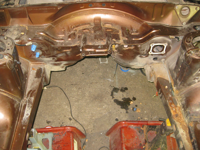

MilesFox Posted May 3, 2011 Author Share Posted May 3, 2011 I gave up on the seam welding as i burned a hole in the floor on my 3rd weld. I decided it's not necessary or beneficial unless this car was caged and prepped for stage rally. I went ahead and undercoated the trans tunnel, por 15's the shifter linkage, modified and hybrided my trans xmember to have double mounts, and stripped the firewall and de-rusted it. Next step is to wash the engine bay with soap and water, and por 15. i have custom mixed color match paint on its way, #569 Metallic Brown and some pro grade clearcoat to repaint the engine bay. From there, i am ready to install the trans. in the meantime, i need to install the shifter. I am using the xt shifter which is quite complicated, so i need to mount it to the body first. i am doing the electrolysis on the suspension pieces, so once the paint is applied, i can go ahead and assemble the engine cradle and control arms XT6 brake booster compared to the ea82. I will have to do a modification similar to shawn w's crossbred performance kit. I am going to compare pedal boxes and see if i can swap the pedal. otherwise, i will have to cut and weld Link to comment Share on other sites More sharing options...

MilesFox Posted May 3, 2011 Author Share Posted May 3, 2011 So how were you able to mod the rear most mounting brace on the crossmember? I forgot to take it with me to mock up. I was going to bolt up the front and center to the body, and bolt up the original cover plate piece that would otherwise be the at trans mount, drill my holes, and back it with some 1/8 flat stock to beef it up, and call that my mount. It also looks like the trans mount on scott's 2000 legacy AT looks to be the same part as the xt6, but in much better shape. I am going to try and use that, and cram it full of 3M windo-weld Link to comment Share on other sites More sharing options...
