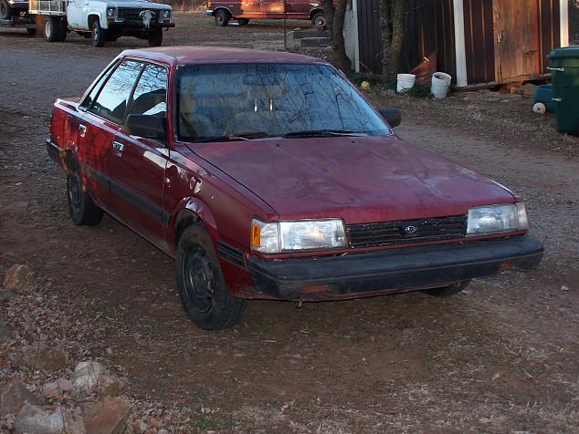

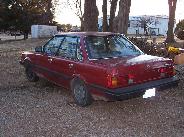

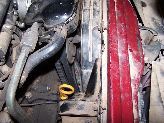

soobenthusiast Posted January 14, 2011 Share Posted January 14, 2011 My father recently got a '92 Loyale Sedan, fwd, 5spd. We've done enough to it, already needed some help, and there is more to do, that I'm starting a thread to document it's progress and ask questions. It's only showing 233,000. The 2nd and 3rd times it was driven the crank pulley came off, it's now torqued to spec with a little Loc-Tite and has been fine. The next thing is shocks, which should be here soon, as there is NO damping left. The muffler is completely gone, so something will need to made so the exhaust goes out the back instead of dumping at the rear wheel. Link to comment Share on other sites More sharing options...
MilesFox Posted January 14, 2011 Share Posted January 14, 2011 Sweet! Love the sedans. Good luck with this car. If there is no rust, it will last many more miles and years with good care. Love it or leave it, good ol' ea82. Link to comment Share on other sites More sharing options...
TheLoyale Posted January 14, 2011 Share Posted January 14, 2011 Good ol' ea82. +1 Looks in good shape, as for not having a muffler, just get a section of 1-7/8" or 2" pipe and run it so it feeds out the rear of the car. Gotta admit, it sounds great without the muffler. Link to comment Share on other sites More sharing options...
Subaru_dude Posted January 14, 2011 Share Posted January 14, 2011 I had an '89 just like that. You'll get 36mpg pretty regularly on the highway if you keep the RPMs around 3k. I think that puts you at about 65mph. Great little run-around car. Link to comment Share on other sites More sharing options...

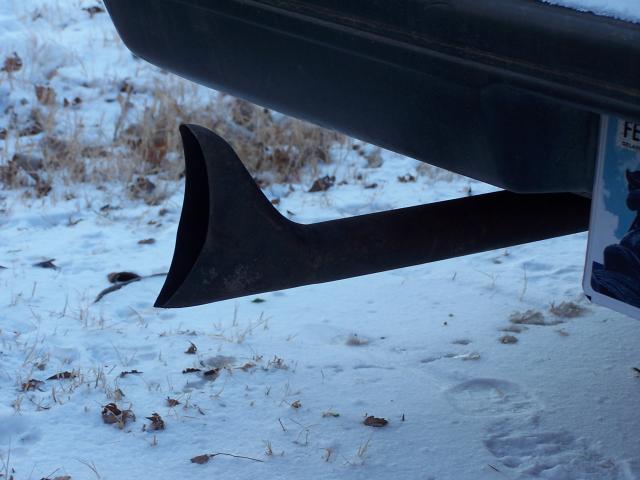

soobenthusiast Posted January 21, 2011 Author Share Posted January 21, 2011 The exhaust now exits at the rear of the car, and sounds quite good. There was about 3 inches of tubing left after the muffler flange, so we just cut the flange off and made a pipe that went back from there. After test fitting several exhaust options to make sure that we got both the aesthetics and the sound right, it was decided that there was only one way to go. Link to comment Share on other sites More sharing options...
TheLoyale Posted January 21, 2011 Share Posted January 21, 2011 The exhaust now exits at the rear of the car, and sounds quite good. There was about 3 inches of tubing left after the muffler flange, so we just cut the flange off and made a pipe that went back from there. After test fitting several exhaust options to make sure that we got both the aesthetics and the sound right, it was decided that there was only one way to go. What the...? Now I have seen everything! Just don't back into anything Wondering how it sounds? Cheers! Link to comment Share on other sites More sharing options...
Syonyk Posted January 23, 2011 Share Posted January 23, 2011 Man... makes me miss my '87 GL. The exhaust was garbage on it, so I rigged something up out of flexpipe & a glasspack, exiting out the side. Damn, it sounded good. *grins* And I set off more than one car alarm idling through lots. Link to comment Share on other sites More sharing options...

soobenthusiast Posted March 18, 2011 Author Share Posted March 18, 2011 (edited) For those wondering, the next things planned for this car are new shifter bushings, and installing a set of foglights and a set of driving lights. The lights are mostly waiting until we figure out how to mount them. The car may even get a radio! but it would probably never be used, it just sounds so good straight-piped. It might even get those decals for the side like the rally Imprezas have. Edited March 18, 2011 by soobenthusiast Forgot something Link to comment Share on other sites More sharing options...
TheLoyale Posted March 18, 2011 Share Posted March 18, 2011 Oh yeah, now I remember this car, it has the shark fin exhaust tip Cheers! Link to comment Share on other sites More sharing options...
soobenthusiast Posted March 18, 2011 Author Share Posted March 18, 2011 (edited) I think you'll remember it next time, because not every Subaru has this much class! And that is actually a fishtail exhaust pipe from a Harley. Edited March 18, 2011 by soobenthusiast Link to comment Share on other sites More sharing options...
