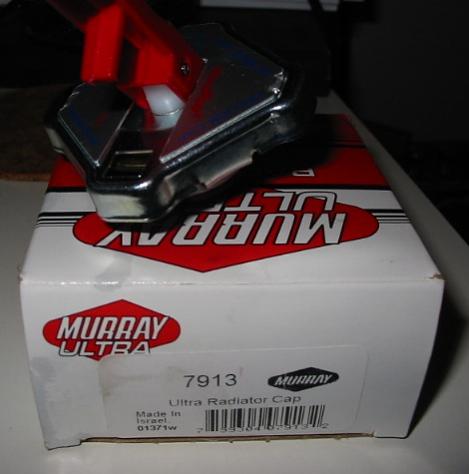

rockbass Posted February 5, 2011 Author Share Posted February 5, 2011 From O'Reilly's... $7.99 + tax. Part # 7913 Link to comment Share on other sites More sharing options...
rockbass Posted February 5, 2011 Author Share Posted February 5, 2011 The radiator cap helps a little. Seems to work best for short trips. I tried taking it on the highway for a few miles...temp shot way up...limped it home. This bandaid won't get me far. Link to comment Share on other sites More sharing options...
idosubaru Posted February 6, 2011 Share Posted February 6, 2011 The radiator cap helps a little. Seems to work best for short trips. I tried taking it on the highway for a few miles...temp shot way up...limped it home. This bandaid won't get me far. interesting thanks for sharing. did you leave it "open" or what? Link to comment Share on other sites More sharing options...
daredevil1166 Posted February 6, 2011 Share Posted February 6, 2011 The radiator cap helps a little. Seems to work best for short trips. I tried taking it on the highway for a few miles...temp shot way up...limped it home. This bandaid won't get me far. By-passing my heater core helped me drive around when mine blew. Less space for exhaust gasses to build up? It also helped to drive at higher RPM's. EG: Shift down to 4th at highway speeds. I might try removing the T-stat. If you can get some better flow out of the system it might help push those gasses out the cap. I don't like the lever vent caps because a stock cap seems to let gas out and keep the coolant in better. That's an awful long way to limp a car. Good luck. Link to comment Share on other sites More sharing options...

rockbass Posted February 6, 2011 Author Share Posted February 6, 2011 interesting thanks for sharing. did you leave it "open" or what? Yes, kept it open. I even shortened the lever by snipping off part of the red tab so it wouldn't touch the hood. I'm not certain how much of a difference this made. I may try removing t-stat tomorrow. Heater bypass too if I can figure out some way to rig it. I agree, that's a long, long way to limp it. Thanks for the PM, we'll talk tomorrow. Link to comment Share on other sites More sharing options...
rockbass Posted February 7, 2011 Author Share Posted February 7, 2011 Update: I gutted the the old t-stat leaving basically the ring to hold the gasket. With the hollowed out t-stat and vent cap open I drove it on the freeway and around the city today. It never got hot and stayed pretty much at the normal, mid-point of the range with only minor fluctuations. On the freeway it ran even cooler. This bandaid may work for the short while until a donor engine shows up. Link to comment Share on other sites More sharing options...
